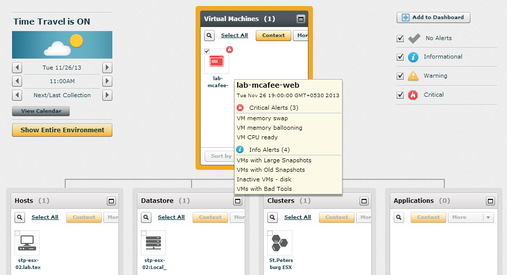

SolarWinds Virtualization Manager provides an informative interface to view the entire virtual environment in the context of a chosen element (such as a host, a VM, a cluster, or a datastore). When you can get to understand the relational dependency between the various elements of the virtual infrastructure, you will be at a better position to infer the cause of resource contention if that’s what is causing your performance issues for a VM.
For each selected virtual component, you can see the mutually associated other elements of the virtual infrastructure. For e.g., if you have selected a cluster, you can relationally see
- all the hosts that form the cluster
- all the VMs that run on all the hosts in that cluster, and
- all the datastores that attached to all the hosts in that cluster
This works in other possible combinations too. A selected datastore would tell you which VMs are accessing storage from it, and which hosts are attached to it, etc. And likewise track down VMs and clusters.
The best part is, as you see all of the virtual infrastructure from VM to host to storage, you will also be able to see the alerts on each of these elements right on the environment map. Just a mere mouse over action will tell you what issues a VM, or host or datastore is having. You can drill down from there to explore further.
So, if you find a VM which is running slow, you can identify the associated datastore and diagnose how many other VMs are consuming resources from the datastore and where this is causing any resource hogging. With this level of information, troubleshooting becomes extremely simpler. You can decide whether to provision more resource to the host, or load-balance the VMs based on business requirements.
Time Travel is another feature of this dependency mapping which allows you to “go back in time” to see the dependencies that existed at a point in time in the past. For example, you can see all of the VMs that were on a particular datastore 3 days ago and which ones were generating the most I/O.
