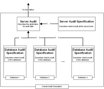

The first step is to create a Server Audit. This is the “kitchen sink” for SQL Server Audit, as it catches events and determines where to send the event output. The SQL Audit Events connector requires the SQL Server Audit output to the security or application event log on the server. One thing to note here - the Windows event log can fill up and be overwritten. Make sure you have modified the retention policy accordingly before you flood the event logs with audit events from SQL Server. It’s also worth noting that the Windows Application event log is less secure than the Windows Security event log - any authenticated user is allowed to read and write from the Windows Application event log.
After you have created the Server Audit, the next step is to create either a Server Audit Specification or a Database Audit Specification. The Server Audit Specification is for events affecting the instance of SQL Server, and you can only have one Server Audit Specification output to one Server Audit object. The Database Audit Specification is for events affecting a specific database, and you can have multiple Database Audit Specifications output to a Server Audit object. Here’s what it all looks like:

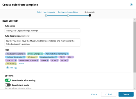

The downside to SQL Audit is the reporting and viewing of the audit event data. SQL Server Management Studio has a log viewer, but the user experience can be frustrating at times. By using SEM we create a better user experience. Not just for viewing event data, either. SEM allows for the creation of Correlation Rules, allowing us to automate actions to take if a specific event occurs. Here’s an example:
I can create a custom rule that would trigger an action, in this case I will have an email sent should a database object change event is found. You can’t do that out of the box with SQL Server Management Studio.
