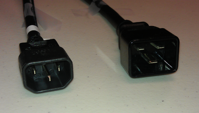

IEC C14-C20:

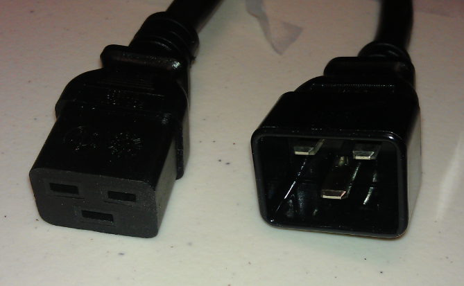

IEC C19-C20:

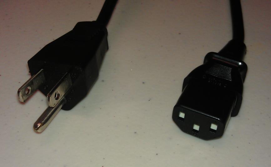

NEMA 5-15P-C13 (mostly North America):

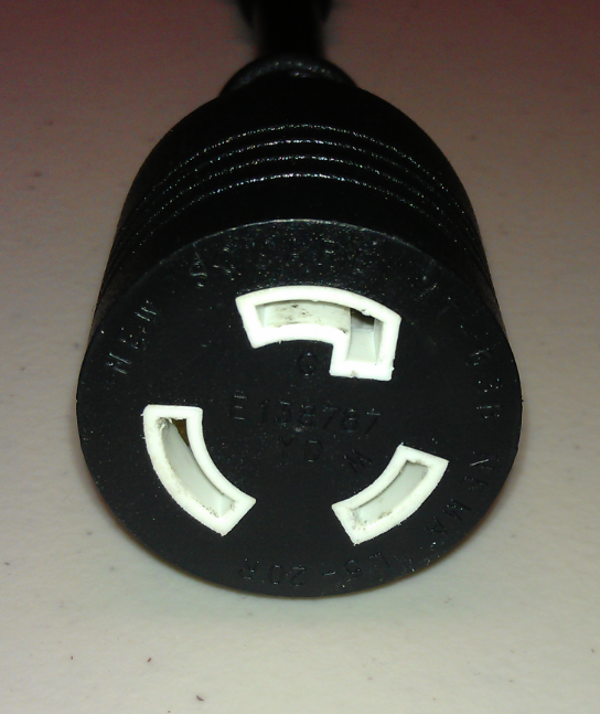

On the other end of that UPS (or PDU) you will have a whole new set of decision points to determine what you need. Apologies in advance for the focus on North American plug types here. High-res pics of other standard (IEC) types would be very welcome in the comments section below. The common input receptacles you will see (or ask your electrician for) in North America will be:
L5-20 (120v/20A)

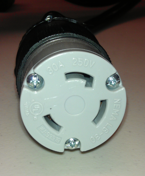

L6-30 (208v/30A)
Less common, and usually seen with big 120V UPSs will be a L5-20. Ever wonder what that horizontal slot was for in commercial building sockets? Now you know. If you’re going 208v, you may also be asked by your electrician if you need a “three-phase” circuit. The short answer is that three phase circuits can handle a heavier load, and that you need a UPS that supports it. The long answer may be found here: http://en.wikipedia.org/wiki/Three-phase_electric_power
