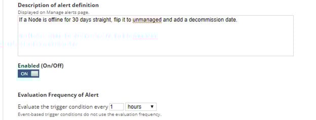

What's the Frequency?
Since our dead nodes alert isn't exactly mission-critical—it's more like good housekeeping—there's no need to check it every minute (which is the default). After a little discussion, I decided once an hour was enough for our needs. You could scale this back to once a day or even once a week (168 hours) if you like.

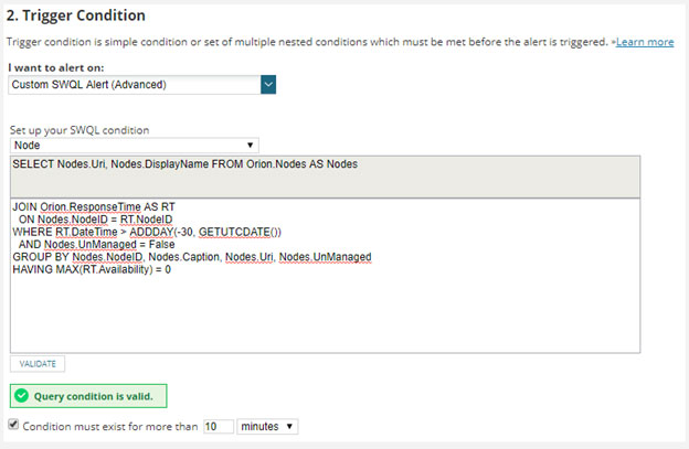

The Power of SQL/SWQL in an Alert Trigger
Thanks to Kevin's knowledge and understanding of SQL and SWQL, he was able to develop the original SWQL query based on the key points I wanted, which were straightforward. I wanted to find all the nodes in my system reporting as "DOWN" for the past 30 days. He came back with the following based off the original thread:
SELECT Nodes.Uri, Nodes.DisplayName FROM Orion.Nodes AS Nodes
JOIN Orion.ResponseTime AS RT
ON Nodes.NodeID = RT.NodeID
WHERE RT.DateTime > ADDDAY(-30, GETUTCDATE())
AND Nodes.UnManaged = False
GROUP BY Nodes.NodeID, Nodes.Caption, Nodes.Uri, Nodes.UnManaged
HAVING MAX(RT.Availability) = 0
I opened SWQL Studio and ran this query to see if it passed the "sniff" test. The results looked pretty good, so I looped in my manager.
After speaking with my manager, I realized we'd cast our net a little too wide. Within my environment, I have some nodes down for over 30 days, but shouldn't be considered "Dead." These nodes are normally found within some of our locations and might be offline because of a natural disaster or the stores simply being remodeled. So, I took what Kevin gave me and changed it up to make sure it wasn't pulling in any devices down for a known reason. The result was this:
AND Nodes.CustomProperties.Store_Known_Down = False
It should be noted that Store_Known_Down is a Yes/No custom property I've tied to nodes so I can mark them as being down for a known reason. Your alert logic will probably differ, but it's important to think about these edge cases.

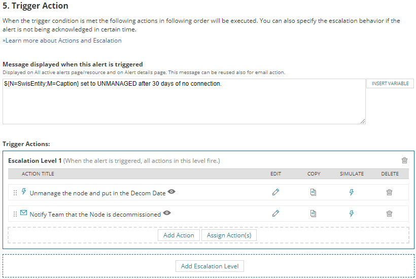

Defining the Alert Actions
With the list of devices from the alert trigger in hand, we next had to address the actions when the trigger occurs. For me, it was key to have both an email message to the system owners and the alert add a "Decommissioned Date" to the existing custom property with the same name. We use this custom property within my environment to track when a node is no longer in use, so having this date was critical for both reporting and alerting logic.
Kevin again came to the rescue and helped me develop the PowerShell script. We then tested the alert in his test lab and BINGO! The system was unmanaged and the custom property value was updated with the current date/time. But more details on the script later.
The Proof Is in the Results
So, after perfecting the query and the script, it was time to test it out. Kevin spun things up in his lab. We started by crafting a new alert and testing the query logic in the alert editor:
The query passed validation, so we've got no syntax errors and are good to move on to the next step.

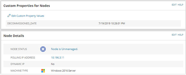

When executed against a testing node, we got no errors in the PowerShell prompt and the Orion pages showed the results we expected. Nice!
As you can see, the node was switched to Unmanaged and a Decommissioned Date was added.
Now that I know the script works, I can add it to an alert action.
Add an action for Execute an External Program and then fill in the details.
The full path doesn't show up in a screenshot, so I'll put it all here for you:
"C:\WINDOWS\System32\WindowsPowerShell\v1.0\powershell.exe" -File "D:\Scripts\Alert_Unmanage-Node.ps1" ${N=SwisEntity;M=NodeID}
It's a very long line, but simple in execution. Let me break it down:
"C:\WINDOWS\System32\WindowsPowerShell\v1.0\powershell.exe" | Full path to the PowerShell executable |
-File | Parameter telling PowerShell to run the script in the next position |
"D:\Scripts\Alert_Unmanage-Node.ps1" | The full path to the script. If you save this elsewhere on your computer, be sure to update the path. |
${N=SwisEntity;M=NodeID} | SolarWinds variable containing the NodeID for the alerted node |
Customizing the Alert Email
The user experience is key in everything, but especially in monitoring. If you're going to use the information in this post, make sure you spend some time crafting the message sent. I wrote it based on how my end users digest their alerts. Your end users may view their alerts differently. I don't need much more than the basics for this type of alert message. I kept most of the default message and then just added some language about it being a dead node. Below is my example of the alert message. [Yes, I know I have a typo in the first line]
So, I have the Frequency of the Alert, Trigger Condition, and Alert Actions (execute a script and send an email)—everything we need for this alert. When completed, the trigger actions list looked like this:
And that's pretty much it for the alert. There are no reset actions, so we're done. I just clicked through the wizard to save it. In my environment, I didn't enable the alert yet. I needed to make everyone aware of what was happening first.

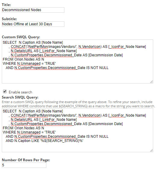

The Results Are In
After clearing it with the necessary teams, I enabled the alert. Within a few minutes, the first system was found, flipped, and timestamped.
The results speak for themselves. My Orion server will no longer waste compute power trying to poll devices that have been offline for 30 days, the associated teams got a message saying I've stopped watching their devices, and I can make a simple custom query resource to show me all unmanaged devices with a decommission date.

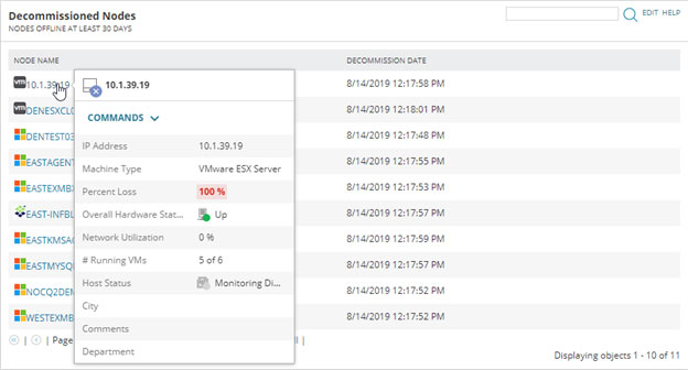

Edit a dashboard, add new widget, search for a Custom Query widget, drag it into your dashboard, and then save the layout.
Edit the widget. Provide a clear name and enter:
SELECT N.Caption AS [Node Name]
, CONCAT('/NetPerfMon/images/Vendors/', N.VendorIcon) AS [_IconFor_Node Name]
, N.DetailsURL AS [_LinkFor_Node Name]
, N.CustomProperties.Decommissioned_Date AS [Decommission Date]
WHERE N.Unmanaged = 'TRUE'
AND N.CustomProperties.Decommissioned_Date IS NOT NULL
For the custom SWQL Query.
If you want to enable the search, enter:
AND N.Caption LIKE '%${SEARCH_STRING}%'
For the Search query.
When done, it'll look like this:
Save that resource and now you have a quick and easy way to search for unmanaged nodes, with hover-over information to boot.

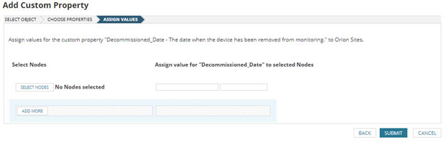

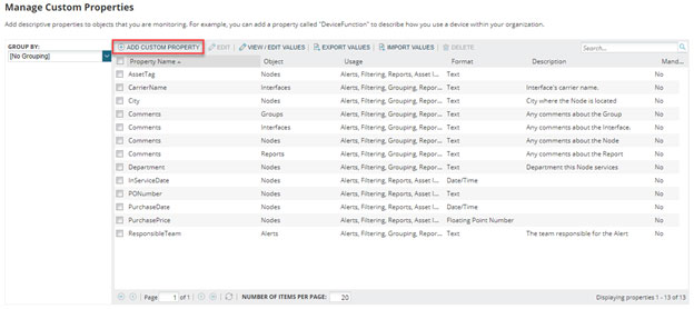

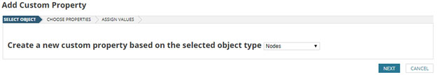

Custom Properties
For the script to execute correctly, you need to have a custom property called "Decommissioned_Date" with the date/time data type and assigned to nodes. To create this custom property, within your admin pages, navigate to the Manage Custom Properties page and click "Add Custom Property."
This custom property will be based on nodes.
Provide the name, give it a description, and select the format as Date/Time. Be sure to keep the "required property" checkbox deselected.
Lastly, don't manually assign nodes with this custom property. We'll let the script do the work.
Note: if you choose to use a different name for your custom property, be sure to update it within the PowerShell script (line 50).
