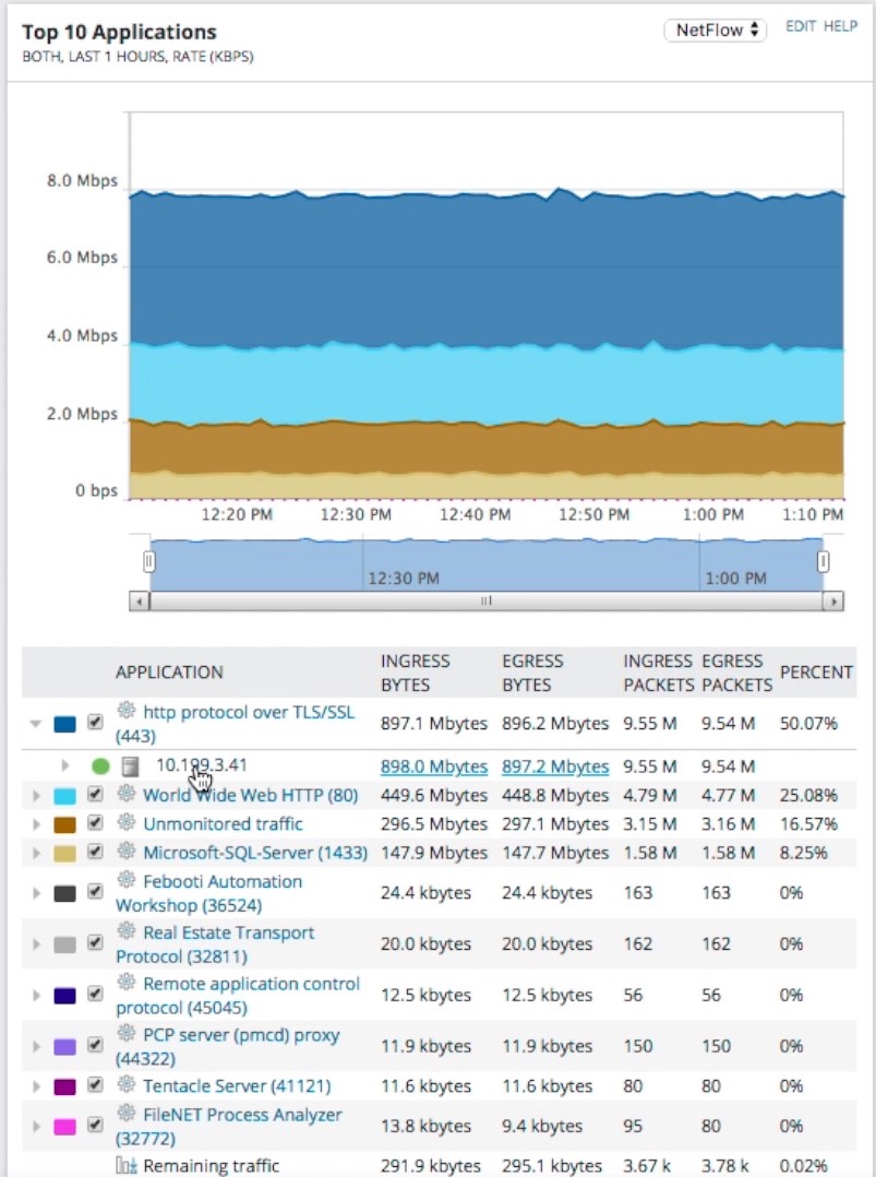

If the application of interest is in the TopN, we can expand it to see where this application is visible and select that source. That will take us to a detail page, which is already filtered by both application and source of the flow data.

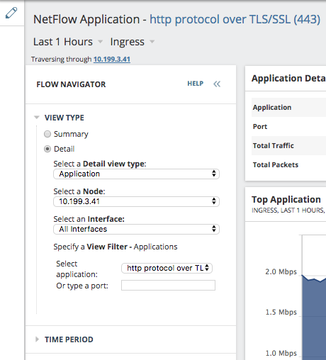

We can also select our source of flow data directly in the Flow Navigator. We can build our alert based upon a node that reports flow, or upon a specific interface:
Once we have a context for an alert, we can select an application. If we use the "TopN Applications" resource, we have already identified both the application and the node or interface where it's visible.

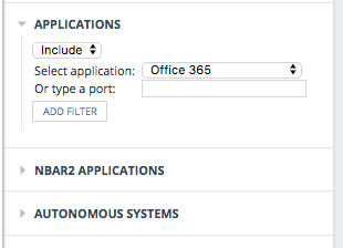

Another way to arrive at this context can make use of the Flow Navigator, where we can explicitly select the application we’re interested in:
We can select either Applications, or NBAR2 Applications, to help describe the traffic. With the context now fully described, we are able to open the "Create a Flow Alert" panel and create our first alert:
