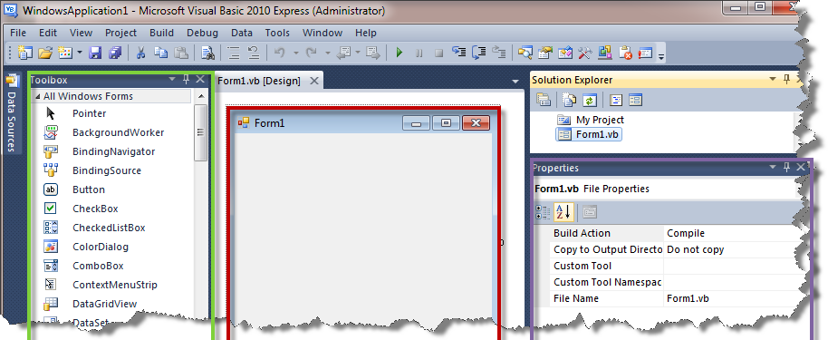

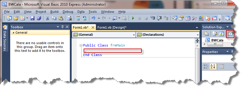

The first question you may have is, "Where does the code go?" From the design screen, you can either double-click the form (or any object on the form) to be taken to the Code View, or, click the highlighted red icon above the Properties window in the Solution Explorer, as shown below on the right. All of the code for this project will fall between Public Class frmMain and End Class, also highlighted below:
