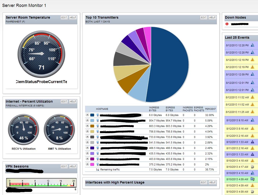

For those of you who have read my posts, you'll know that I love to tinker and share my "tinkerings" with you. To date, we have the following toys:
