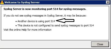

For example let’s assume that a syslog application was installed on a server only to find out that port 514 is already in use. To determine what application is blocking the port we must perform the following steps:
1. First we notice that port 514 is already in use:

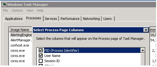

3. Note that the Process ID (PID) associated with the blocked port is 6724. Now we need to find out what application owns PID 6724. To do this we bring up the Windows Task Manager and under “View” and
“Select Columns…” select the option for “PID (Process Identifier).”
Next Click “Ok” and you will now see the PIDs displayed in Windows Task Manager.
