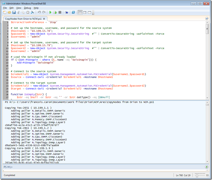

Here is an example of run, which extracted 561 nodes from my NPM 10.2.2 and imported them into my NCM 7.0.2
- The upper panel of PowerShell ISE contains the script. The first 2 blocks define hosts and credential for your data source (NPM in this example) and target (NCM in this example). These need to be changed for your environment, of course.
- The second panel shows the trace of the run. Should be pretty self explanatory.

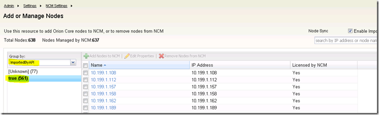

- After the run, the target system (NCM 7.0.2) had 561 more nodes. As you can see, the nodes added by the API, are “tagged” with a property called “ImportedByAPI”, so you can easily identify, group and mass-modify them if needed.

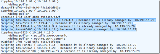

- Nodes that already exist (same IP) in the target system, are skipped. The trace will send you messages such as this:

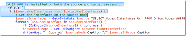

- The script as uploaded, actually ignores interfaces and volumes, but just because the 2 relevant sections are “commented out”. Look for sections like this and remove the If (0) {…} to enable them and start moving interfaces and volumes too (interfaces requires NPM network management software on both sides of the script, of course)

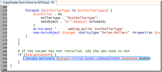

- If you run this script against an NCM 7 target, prior to 7.0.2 (i.e. 7 or 7.0.1), the added node won’t be manageable by NCM (they will just be in Core), you will need to add them manually to NCM, using the Add or Manage Nodes UI. NCM 7.0.2 has a new API verb that imports the node up to NCM, so it becomes immediately and automatically manageable by NCM. The last line of the script takes care of this:
