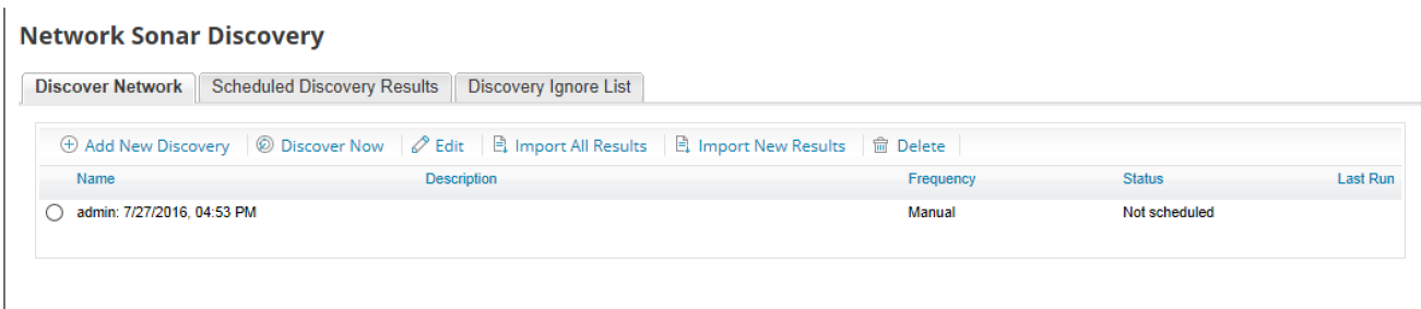

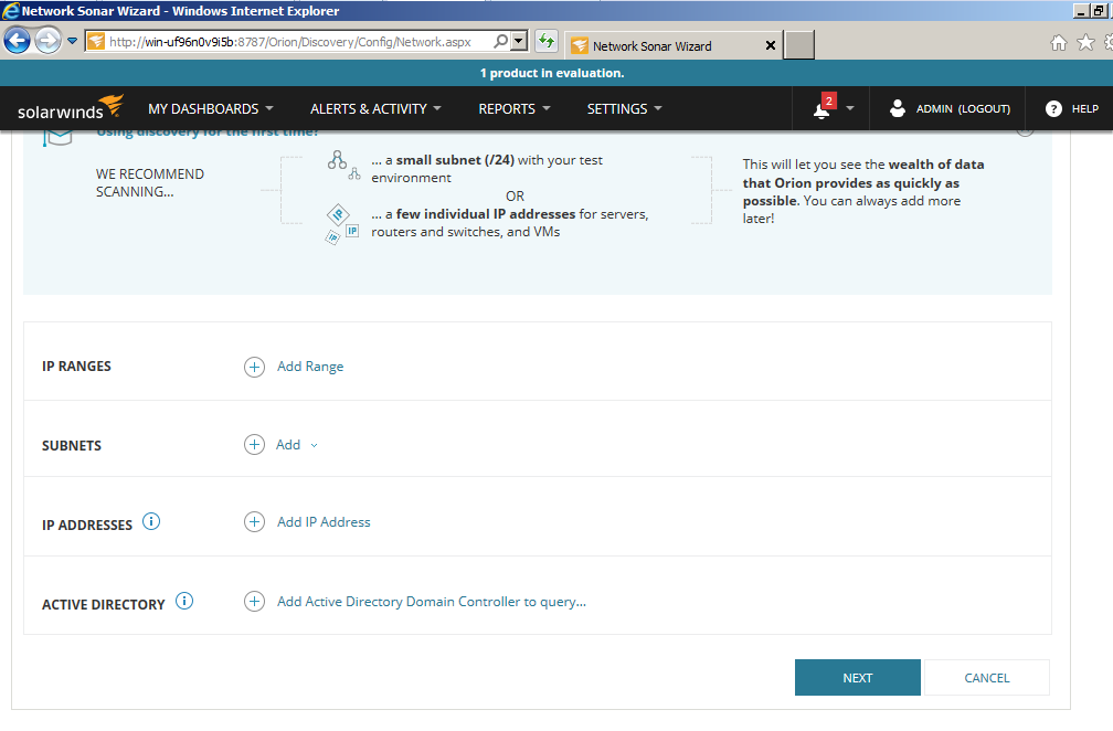

Before I cover NetPath and NetInsight, I'd like to go over the changes Solarwinds made to the NPM12 GUI. Once the NPM12 installation has finished, and open up the web gui, you'll be greeted with a login prompt. By default, there's no password (you can always set one in the admin page later), so just click login, and you'll be taken to the network discovery wizard.

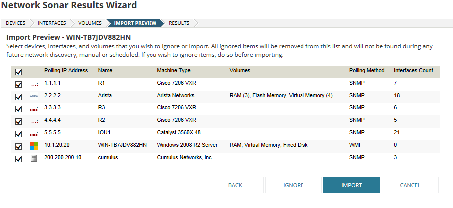

At this point, you can add IP ranges, subnets (in CIDR notation), specific IP addresses, or even have it poll a Windows AD Domain Controller. There is an option under subnets to have it pull subnet routes from a seed router, but I never really got that working properly, even though the 7200 IOS image I had directly connected the NPM12 contained a properly populated routing table, and I ensured that all the other nodes MAC addresses where in its ARP cache:

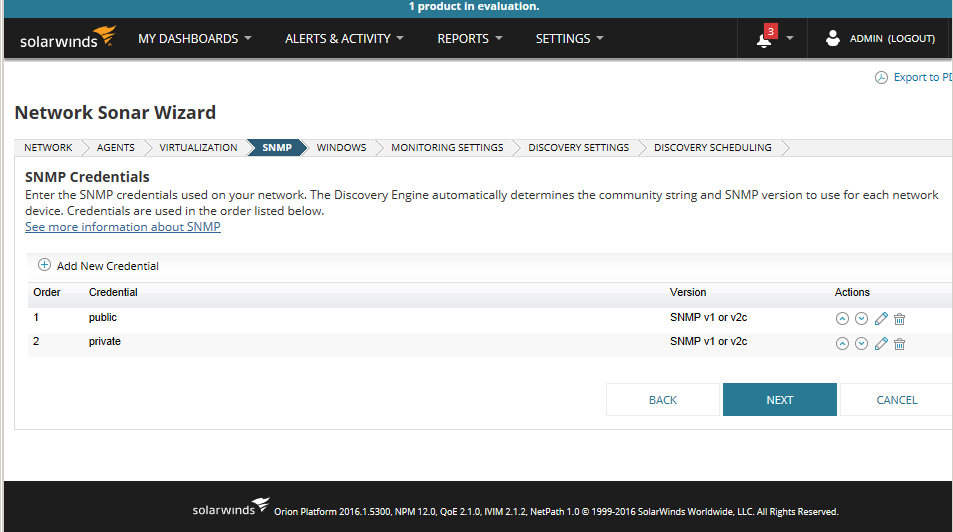

After using whichever method you choose to define the devices you want NPM12 to discover, click next and you'll be taken to screens that will prompt you for agent polling, VMware ESXi polling, SNMP credentials or WMI credentials (for Windows servers that don't support SNMP). Since I didn't use agents, ESXi, or WMI setups in my test topologies, I'm not going to go over that, but I did use SNMP v2c for simplicity sake, as well as NetFlow v9 and sFlow.
By default, it has v1 and v2c public/private credentials set up, but you can always edit those to non-default values, or better yet, click "Add New Credential" to set up SNMP v3. In a virtual lab environment, using just the default v2c public community is fine, just be aware that some VMs are set to use SNMP v3 by default, and obviously you'd want to use that, if you're going to have the NPM12 server deployed in a physical lab or production environment.
Since this was just for a lab demo, I left them mostly at the default values (I did up the Hop Count, though), and proceeded to the next to last screen. You can set the frequency of the discovery scan, and whether or not to run it immediately. While it's running, you can watch the status bars, if you want, but there's also an option to have this run in the background, which I liked, since it let me do some other things, instead of just twiddling my thumbs.

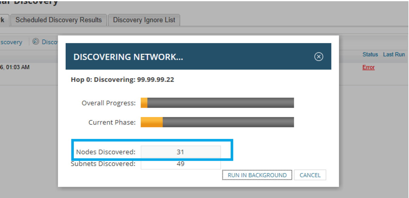

Once NPM12 has finished scanning, it will import all the devices, and amount of ports each one has.
If you need to re-run the discovery process again, you can highlight username of whichever user created the scan, and then click "Discover Now". It doesn't override the devices/interfaces that were previously scanned, it just import the new ones.

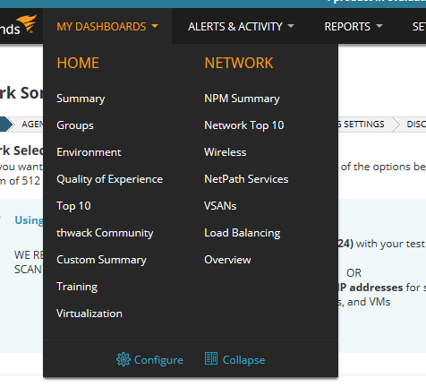

Now I'd like to talk about one of the big things SolarWinds has been talking about, in regards to NPM12: Customizability.

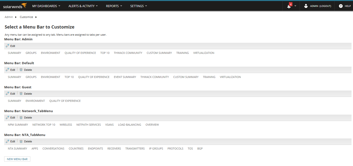

Pretty much anything and everything can be customized in the Web Console, so you're no longer faced with having to deal with see a bunch of stuff you don't want to see. Case in point, here's the default view in My Dashboards:

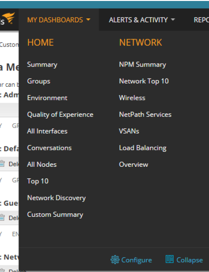

That's all well and good, but what if I have zero desire to have thwack Community or Training in there, and would prefer to just have the options I'm more likely to use on a daily basis? Well, just click Configure down at the bottom, and you'll be taken to this screen:
The Admin bar is a misnomer, since that edits the Home section of My Dashboards.
If you want to edit Network or NTA, you need to edit the Network_TabMenu and NTA_TabMenu.

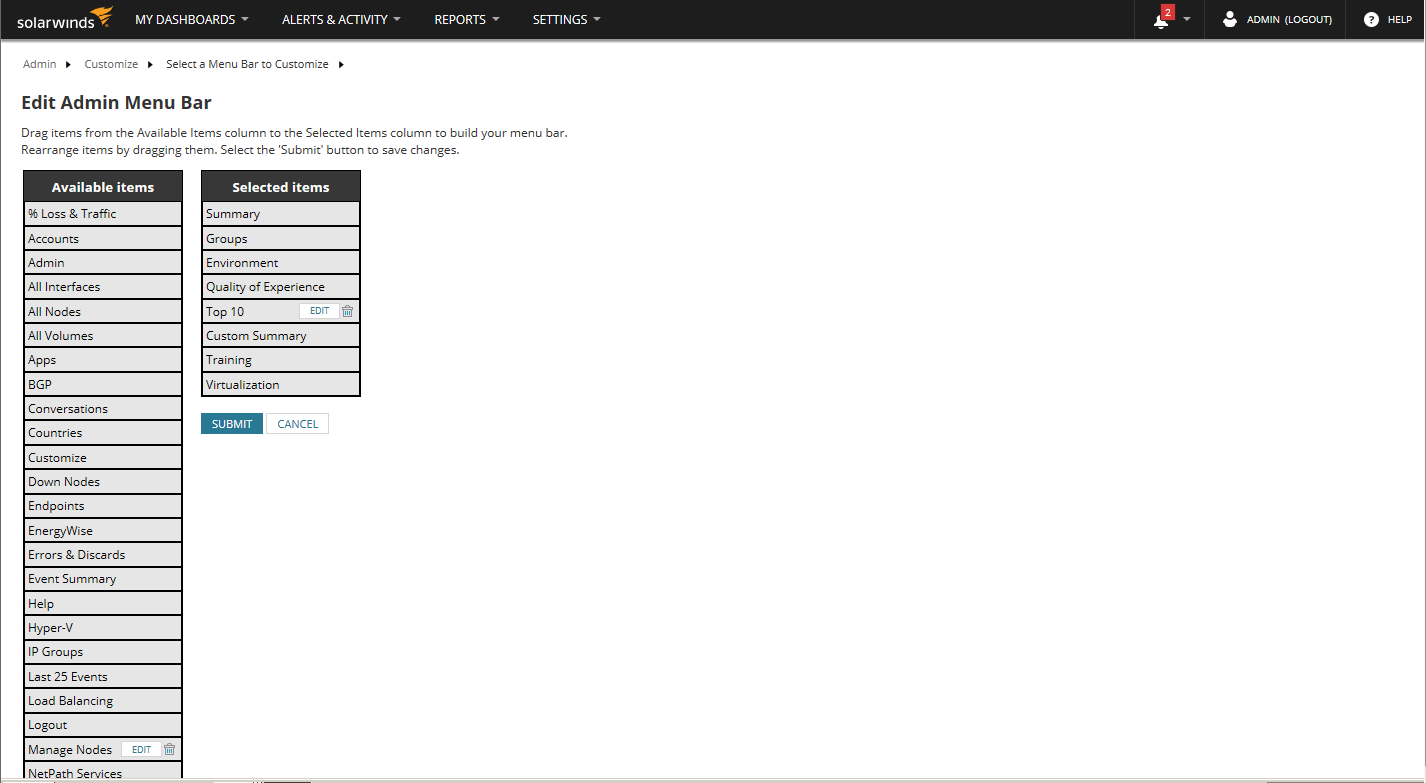

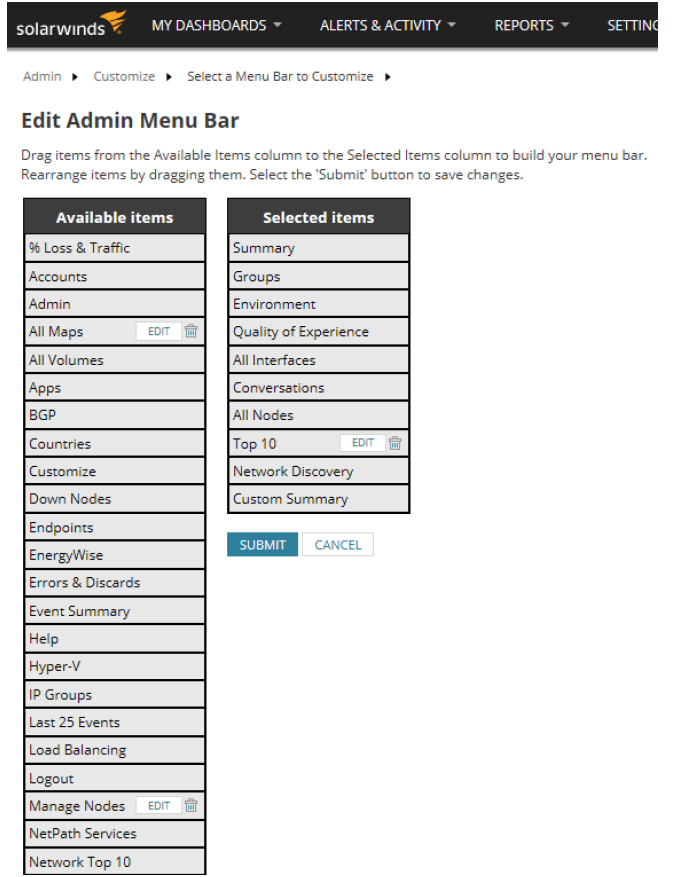

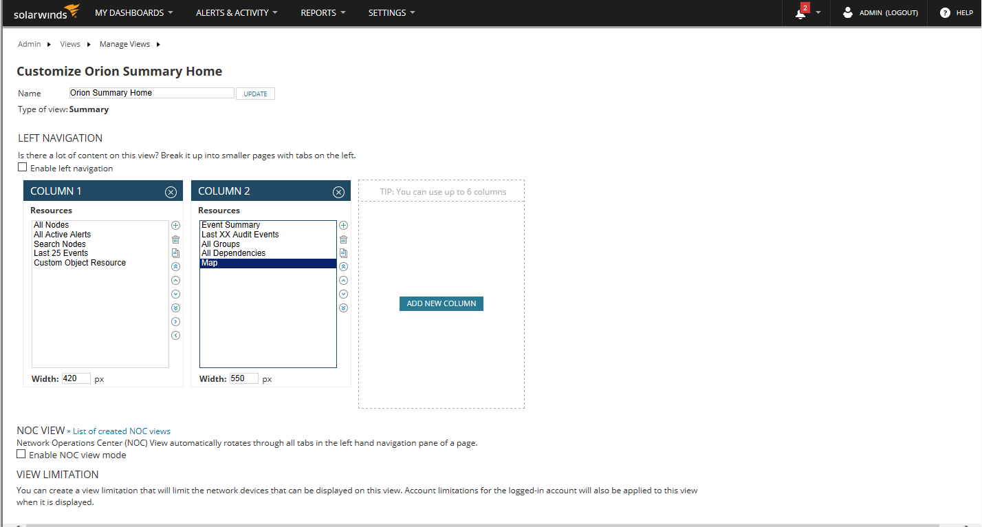

Now, let's edit that “Admin” bar to get rid of a few things, and add a few things I'd rather have on there. Click Edit, and you'll be taken to this screen:
What appears in the Home section of the Dashboard is on the right, and all the possible entries we can add are on the left. To make changes, just drag and drop between the two lists, in order to add/remove entries. Here's an example I did, where I got rid of thwack, training, and virtualization, and then added Network Discovery, All Nodes, Conversations, and All Interfaces:
Just click Submit, and you're done. Here's what the Home section of My Dashboards looks like now:
You can do the same thing will all the other dashboards, as well. You can also customize each individual page, so you can see only the info you want, without having to scroll past a bunch of junk to get to it. If you click Customize Page on the far right of each page, you get taken to a customization screen, like this:
You can add/remove items, change column widths, or even add additional columns (up to a total of 6). It all makes it so much easier to find the info you're after that much faster.

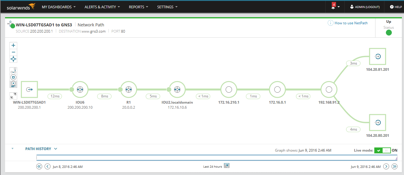

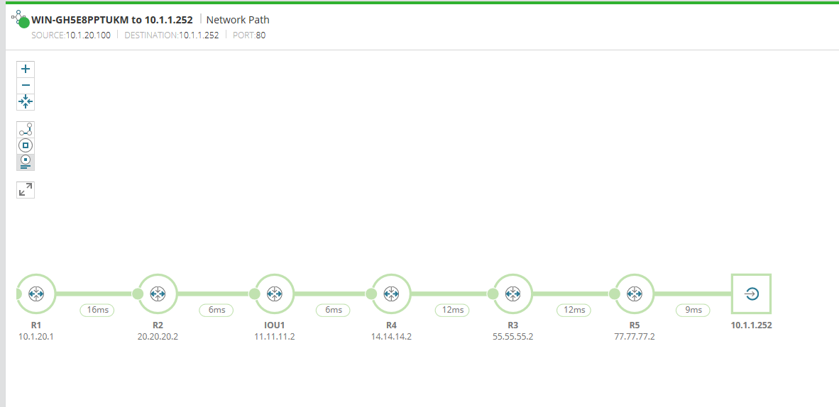

NetPath worked just fine when showing me the path it took from my NPM12 server VM to another endpoint contained within the GNS3-VM. In this screenshot, I created a probe on the NPM server VM that was set to poll ASW1 on a specific port, and it correctly traced the optimal path through my topology to ASW1:
I failed to screencap the topology itself, but it was decent setup using eBGP I artificially decreased the speed on a few of the links, and NetPath showed the best path it was taking, to probe ASW1

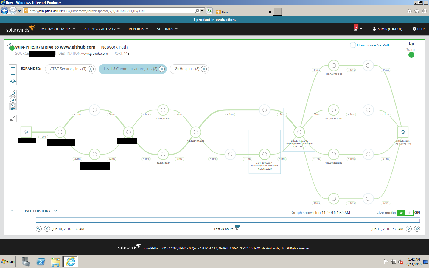

What I did next was to just take GNS3 completely out of the equation, and bridged my NPM12 server VM into my home lab. This time, I saw the types of results I was expecting:

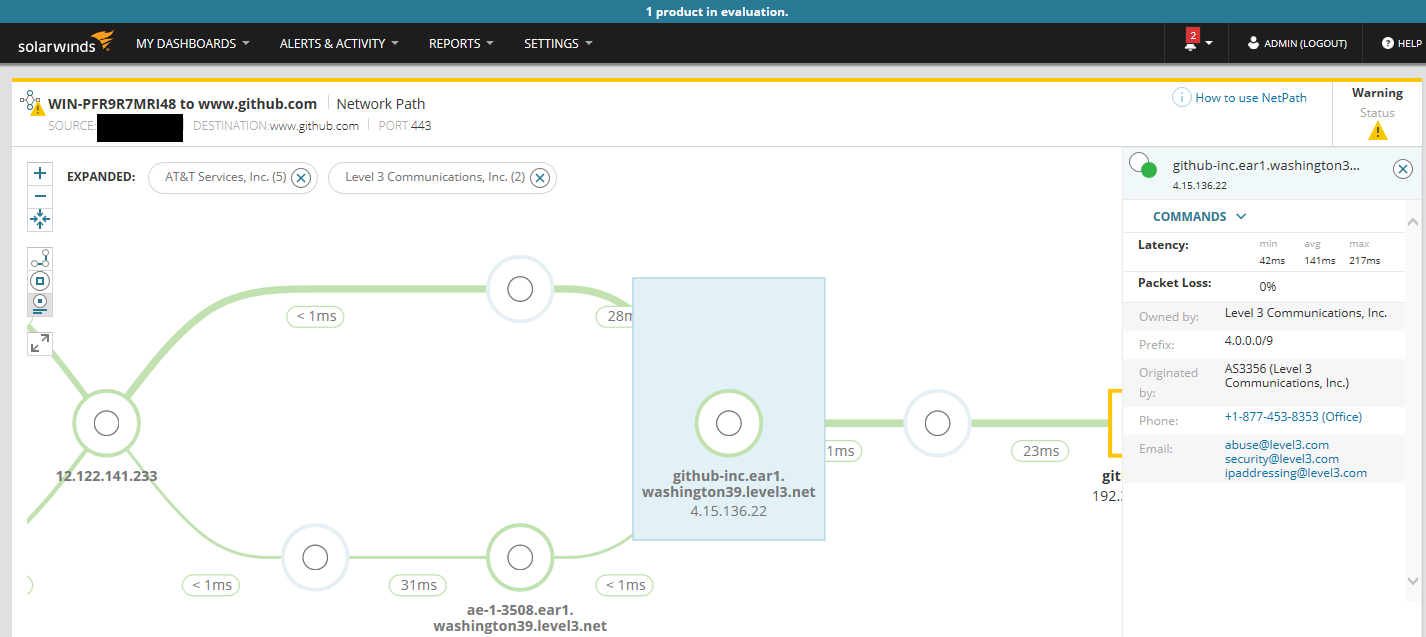

I created a probe to Github, and I started seeing nodes not only for my ISP (which I blanked out), but I also could see nodes belonging to Level-3. The longer I ran the probe, I'd notice nodes pop in and out, but still, it was really cool! If you hover over a specific node, it will also highlight all nodes belonging
to that provider! Pretty neat!
If you click on a specific node, you can see the contact info, prefixes, and AS number, like I was expecting:
I really like this tool! I still think it would really be useful in a larger network (like a CDN), but I can imagine some uses for it, for smaller shops.

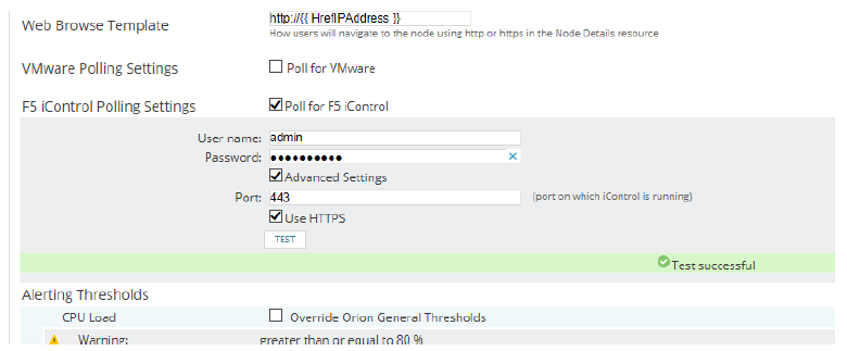

Enabling NetInsight polling in NPM 12 is actually incredibly easy. You just click on Manage Nodes, select your F5 load-balancer, and check “Poll for F5 iControl”. Add your administrative credentials for that node, and click Test.
By default, the F5 VMs include a self-signed certificate, so you WILL get an error. Just choose to accept the certificate, click Test again, and it will pass the test. Repeat for the second load-balancer, and you'll be ready to check this out. In order for NPM to monitor the health of the F5 balancers, you'll need to have some virtual servers and pools configured. I ended up using a LAMP server built on Xubuntu, that had multiple apache2 websites that purely responded to port 80 and 443 requests (I also had to create several sub-interfaces on that LAMP server, for reachability).

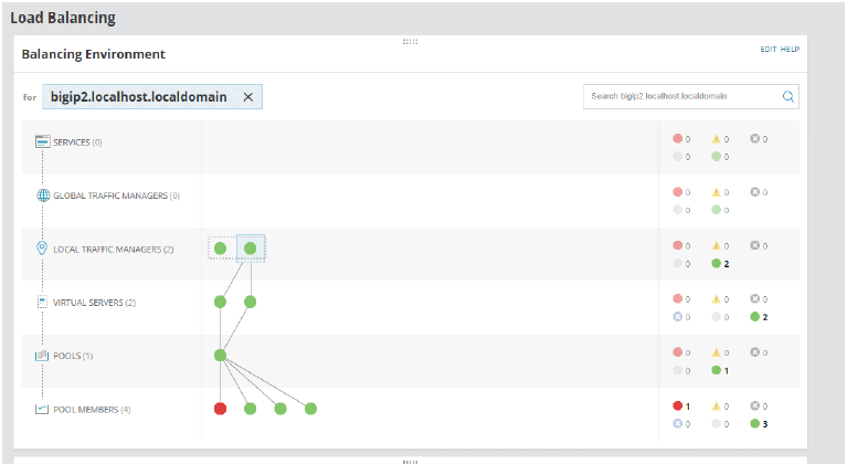

Since those websites were very limited, there was hardly any raffic to see in the “Concurrent connections” section of the load-balancing page.

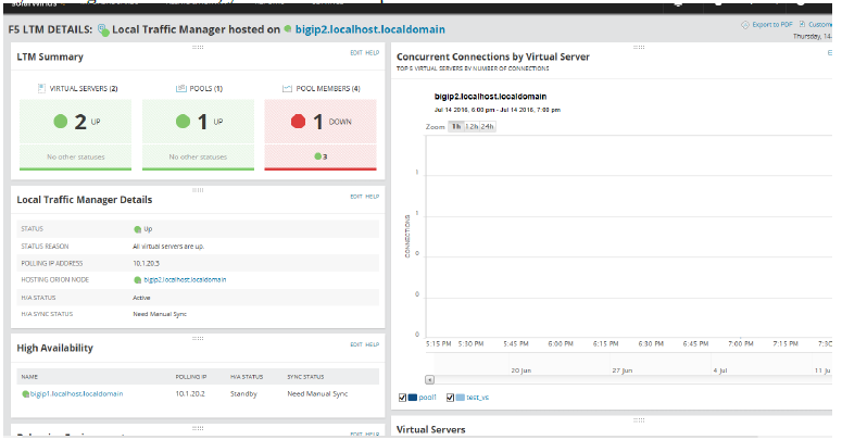

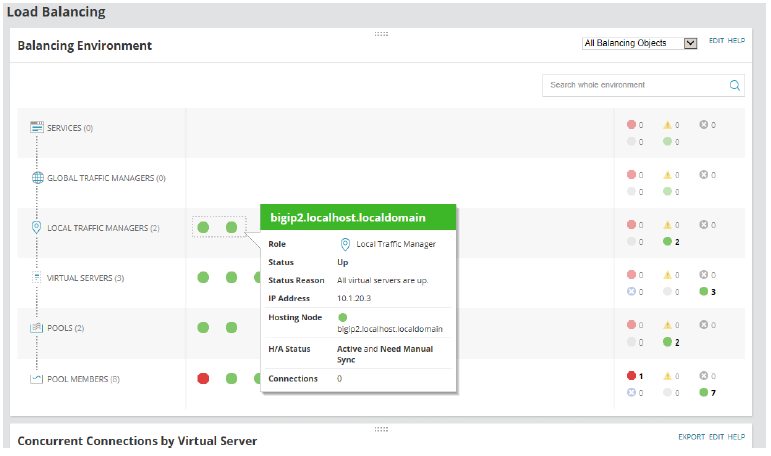

To check out the health of the F5 devices, click load balancing from the dashboard, and you'll see this:

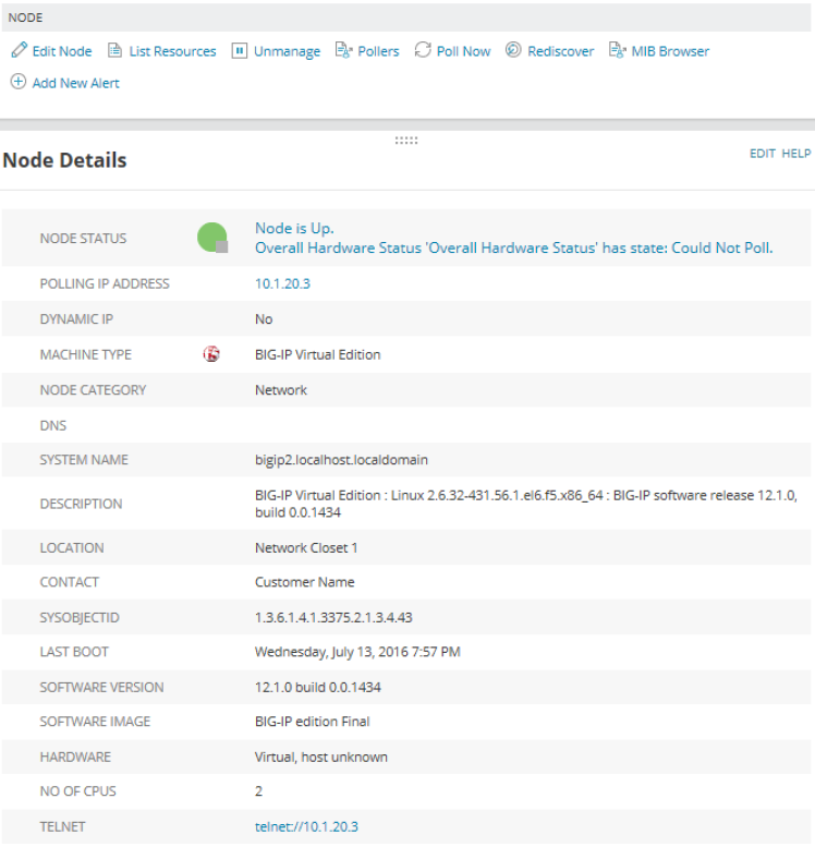

I happened to have my cursor hovering over one of the LTMs, as you can see, it'll display its role, status, status reason, ip address, FQDN, and it's HA status. If you right-click on either of the LTM nodes, you can either see detailed information on that node, or it will display all the virtual servers, pools, and pool members associated with that LTM.
The below image shows which devices are associated with the selected LTM:
By clicking “show details”, you can see more specific device information:
Ignore that one pool member being down. I'm not sure why LTM2 thinks it's down, while LTM1 thinks it's up. Weird….
This page will also list the software release on the monitored nodes, as well as any other relevant info you might want to see (it also does this for all nodes).
