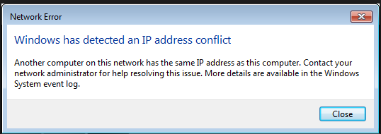

IP Address conflict is a typical nightmare of admins. IP Address conflict occurs if there are two or more devices in your network and have the same IP Address configured.
This is an issue that could arise on devices across any operating system that connects to a local area network (LAN) across any operating system, wired or wireless.
What problems may IP Address conflict cause?
Primarily network connectivity issues. Impacted machines are loosing internet access or general network connectivity until the conflict is resolved. It can impact laptop, VoIP phone or application server.

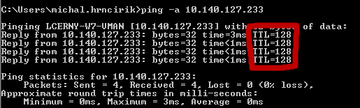

First, you need to know who caused the conflict and find the MAC addresses that are in conflict. If you have such possibility, unplug device which should have correct IP address. Then use 3rd machine within the subnet to PING the IP address in conflict. Use "ping -a x.x.x.x in order to get two important values. First DNS name of machine which causing the conflict, second TTL value, which may help you to identify operating system. For example Windows has typical TTL 128, Linux may have TTL 64. You may find the whole list here.

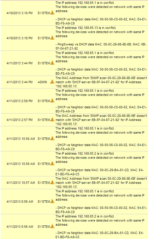

As I stated above, IPAM 4.0 can now actively detect IP address conflict. We primarily focused on alerting and information about MAC addresses which is a key-point information for conflict troubleshooting. IPAM actively scans the network and if it detects duplicate static IP assignment or duplicate IP provisioning form DHCP server, it will trigger an alert with conflict information:

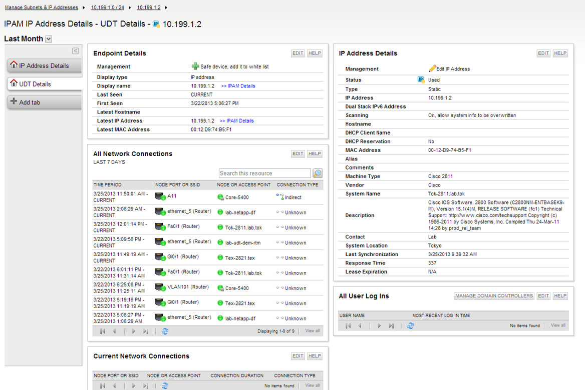

Once you see IP Address in conflict, simply click on the IP or MAC address info in the alert message and it will take you to the IP address detail page, where you may see MAC address assignment history. Another IPAM 4.0 improvement is better integration with UDT product. So you may directly see device & port where are machines connected.

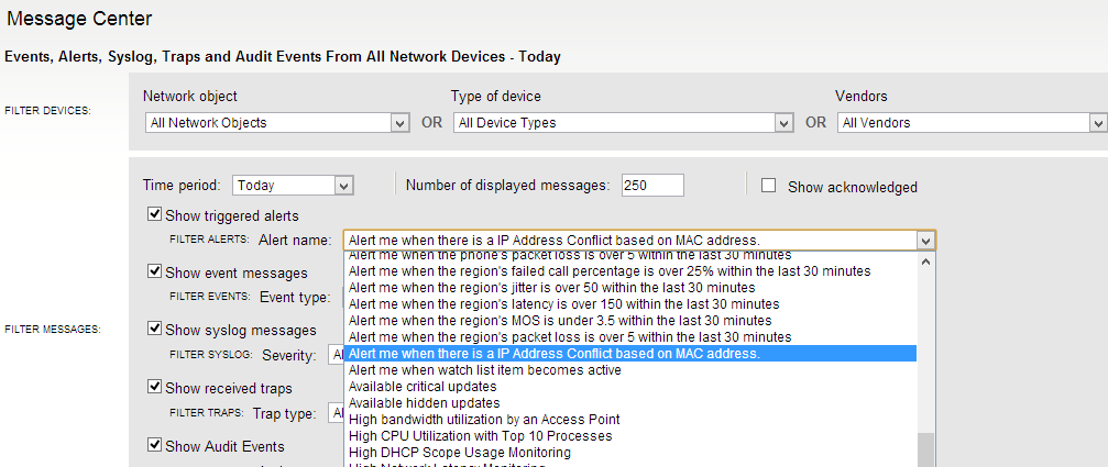

You may use IPAM Message Center too and get all history of IP Address conflicts:

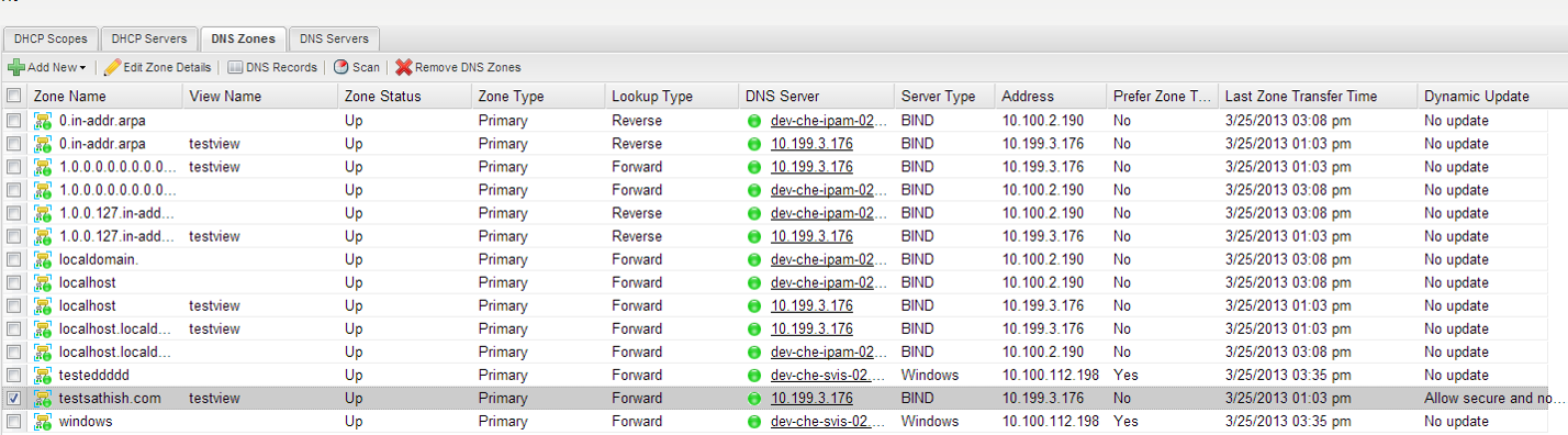

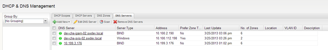

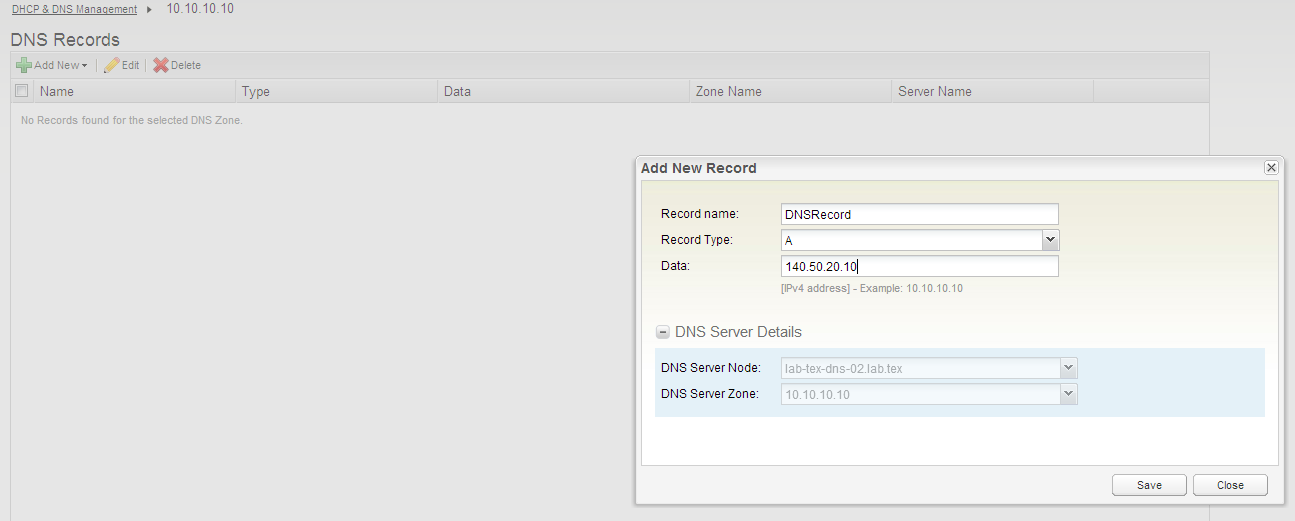

BIND DNS is one of the most used DNS solutions. IPAM 4.0 now adds support for monitoring and management of BIND DNS services on Linux. You can now manage your Microsoft DNS and BIND DNS via one web-console. IPAM supports all important DNS tasks like automatic monitoring and management of DNS zones, two-way synchronization of DNS records and DNS server availability.

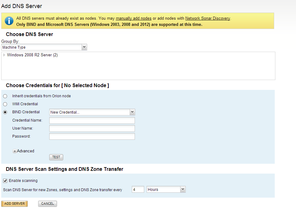

If you want to add your BIND DNS server into IPAM use short wizard that will lead you through the process of addition. When added in IPAM, it will sync and import actual BIND DNS configuration and then you can monitor or manage zones & DNS records:
