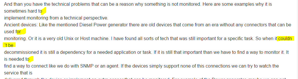

And than you have the technical problems that can be a reason why something is not monitored. Here are some examples why it is sometimes hard to implement monitoring from a technical perspective. Ancient devices: Like the mentioned Diesel Power generator there are old devices that come from an era without any connectors that can be used for monitoring. Or it is a very old Unix or Host machine. I have found all sorts of tech that was still important for a specific task. So when it couldn´t be decommissioned it is still a dependency for a needed application or task. If it is still that important than we have to find a way to monitor it. It is needed to find a way to connect like we do with SNMP or an agent. If the devices simply support none of this connections we can try to watch the service that is delivered through the device or implement an extra sensor that can be monitored. For example of the Power generator, maybe we can not watch the generator directly but we can insert some devices like an UPS that can be watched over SNMP and shows the current power output. With intelligent PDU in every rack you can achieve even more granularity on the power consumption of your components. Often all the components of a rack have been changed nearly every two years, but the Rack and the power connector strip have been used for 10+ years. The same is true for the cooling systems. There are additional sensor bars available that feed your monitoring with data for the case the cooling plant can not deliver these data. With a good monitoring you can react before something happens.
