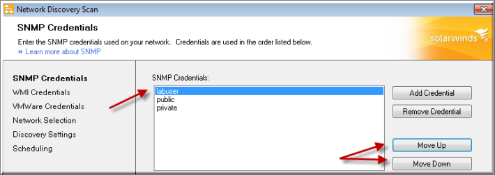

2. Credentials priority - The credentials most commonly used should be at the top of the list, be it SNMP, WMI or VMWare. Performing this simple activity will help enhance the discovery. Also, note that the more credentials there are the longer discovery will take so don’t use any unnecessary credentials.

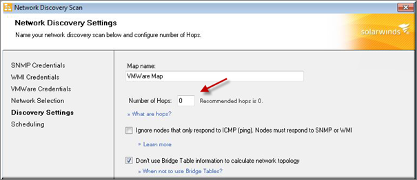

3. Zero Hop Discovery - As you work your way through the discovery wizard, you will notice that you are prompted to provide the number of hops you wish to use during the scan. We recommend using 0 hops unless you are not finding all of your expected devices. The more hops the scan goes through, the longer it takes and 0 usually gets them all.
