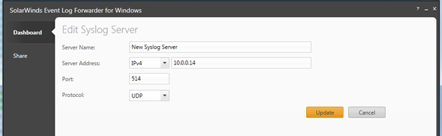

Step 1: Configure the event log forwarder agent on the host that is collecting the Windows event logs (refer to last week’s blog for configuring forwarding and collection).
Define the transport to the syslog server.

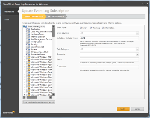

Define the event log subscription, which is the list of events to be sent to the syslog server.

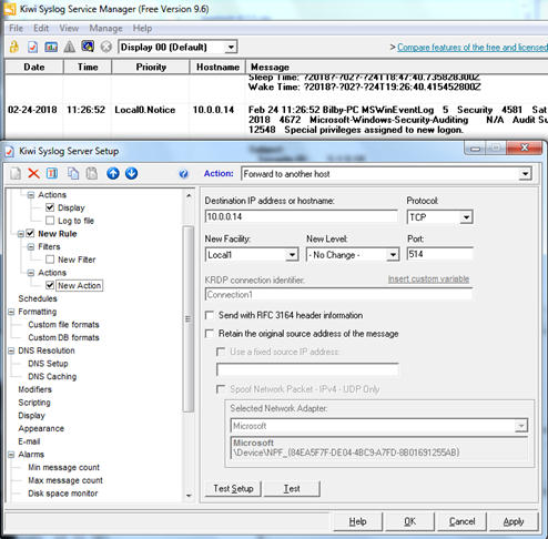

Step 2: The syslog server should be configured to listen on the correct port. It will receive those events defined in the subscription above.
Step 3: The syslog server can be configured to forward events to another device, such as a SIEM tool. The example below shows how to configure an action that will forward the Windows events from the syslog server via syslog to another host. The events may have an RFC 3164 syslog header appended to them to indicate the original IP of the syslog server (useful if NAT may change the source address of the IP datagram), or you can send the syslog message using the IP of the original source of the event. Another option is to use just the original source IP address of the syslog host. This decision often relies on how the receiving host application process and indexes events.
