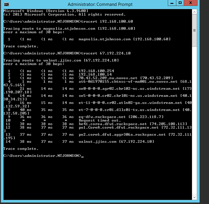

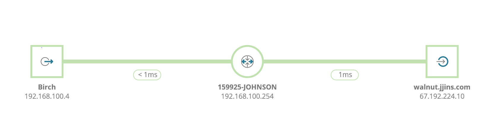

I am having trouble getting the same results from a tracert. I have attached the tracert information and then the NetPath information. The tracert is what I was looking for from NetPath. What am I doing wrong in NetPath?

Did you catch my response earlier in the thread? #2 highlights the most common reasons we have seen the topology shown in the screenshot of this thread.
this was the issue. When I removed the proxy in the firewall from http and https it worked. now I only need to figure out how to make it work with the proxy. thanks
Thanks cobrien, I did catch your response.
Reason #2 is invalid in this case - there's no proxy, nor any device spoofing the destination. (www.google.com for example...)
