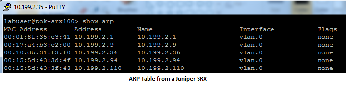

The process starts with a ping! Login into your core switch and ping the unknown IP Address. This lets your core switch learn the MAC Address of the device and add an entry about it to its ARP table. You can then do an ARP lookup to find the IP to MAC mapping. The ARP table shows the MAC Address mapped to that IP as well as the port on the switch which points to the MAC address. Find what is connected to the port and if it is another switch, repeat the process till you find the device.
If you happen to have Layer 3 as well as Layer 2 switches in your network, remember that an ARP table is available only on your Layer 3 switch whereas on a Layer 2 switch, you have to look up the MAC Address table. The reason is that an ARP table is used for Layer 3 to Layer 2 mapping which is needed only by a Layer 3 switch. On the other hand, the MAC Address table holds the mapping for Layer 2 to switch port, and that is usually seen on a Layer 2 switch. Once you reach the rogue device going through all the different layers and switches, you know what your action ought to be.

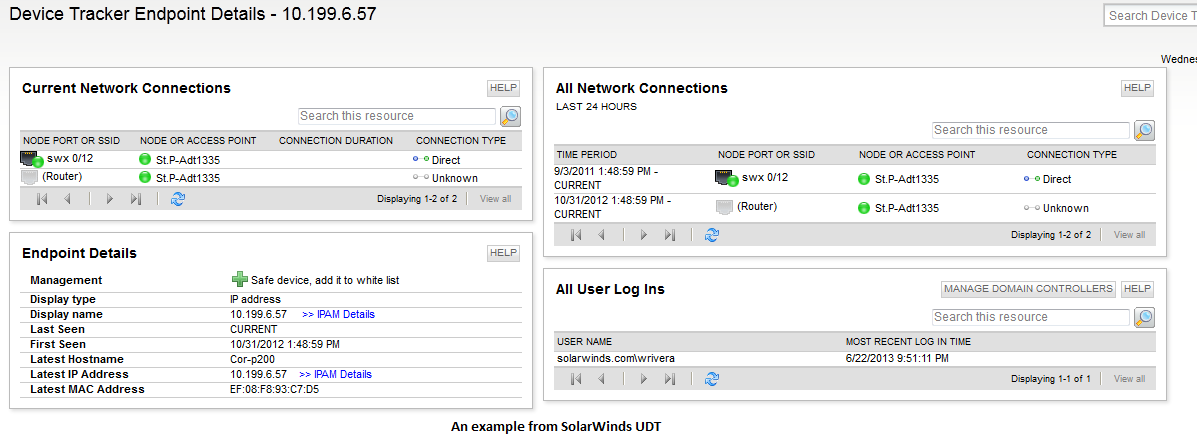

This is why network administrators should deploy tools that can help detect unauthorized network devices, shut down ports as soon as you find a rogue device, track suspicious activity or even create a whitelist for trusted devices. With a user device tracking tool for the network, you can be sure of finding unknown devices within minutes. So, There’s Waldo!
To overcome that bonus difficulty level we added, the tool should also be capable of storing history of the device, like where it was connected prior to disappearing. Even more importantly, if you see that the device is wreaking havoc in your network or if you think the device to be suspicious, rather than having to open putty, login into the switch, search the port and then perform the shutdown action from the switch, you should be able to do a remote shut down with a click from the tracking tool. And finally, if the tool can integrate with your DDI solution to help with IP Address management, even better!
