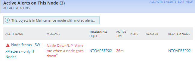

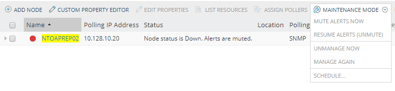

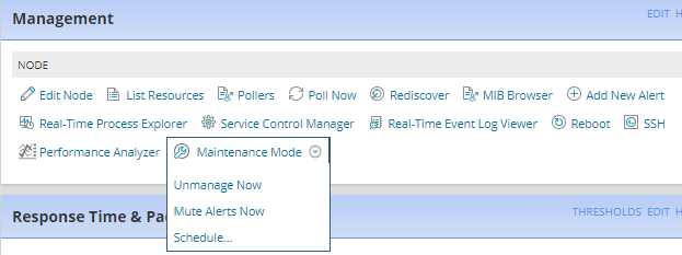

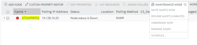

Web Console does not reflect that Alerts are Suppressed in managed nodes:
Same on Node Details Page:

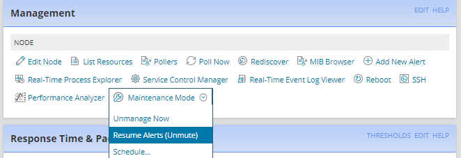

If I use Web Console to Mute alerts - both show that Alerts are Muted as status:
