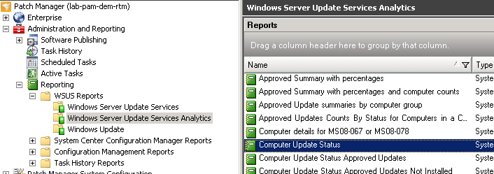

Drill into the Update Services -> SUP node of the Patch Manager console, right-click, and select WSUS Inventory to launch the inventory configuration dialog. Use the default options, and configure the task to run at a time and frequency appropriate to your needs. Typically, this would be a daily task run during non-working hours.
Using WSUS Reporting
Once the WSUS Inventory task has completed, you can use the reports and datasources in the Patch Manager MMC console to access the client-reported state information. The best place to start is the Computer Update Status report, which is a general report for all clients and all updates showing the installation state for each update on each client. Updates identified as "NotApplicable" are automatically suppressed from this report, so the report focuses only on the installable updates and whether or not they are installed.
Make special note that in a Configuration Manager environment, there are no update approvals, so you might wish to remove the Approval State column from your reports since it has no meaning.
