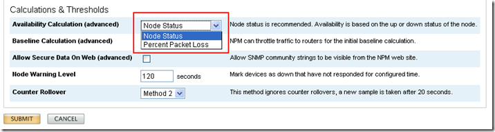

There is one other piece to this, which is how Orion calculates a node’s availability over time. What’s the difference between status and availability? To keep it very simple, a node’s status is an indicator of what the node is doing now; a node’s availability is a measurement of that node’s status over time. Orion calculates availability in two possible ways: either by historical node status, or by packet loss percentage over time. We give you the option of specifying which calculation to use. This setting is under Admin>>Settings>>Polling Settings (screenshot below).
I won’t go into a great deal of detail about these two settings, as you can read about them in the Administration Guide here; however, there are a couple of worthwhile points to mention about them. First, Node Status is the simpler calculation. It’s very straightforward; it basically looks at up/down status over time and calculates availability based on that. This leads me to my second point: use the Node Status setting unless you specifically need to know node availability based on packet loss. The Percent Packet Loss calculation is more complicated; don’t bother with it unless you specifically know you need it.
