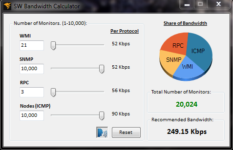

A while back, I took it upon myself to create an internal tool we needed here at SolarWinds. Hence, the Bandwidth Calculator was born. This calculator was designed specifically for SAM to estimate the recommended amount of bandwidth needed for a certain amount of component monitors based on their protocol. As you can see below, 21 WMI component monitors would, on average, use the same amount of bandwidth as 10,000 SNMP component monitors. In this series I will explain step by step how I built this calculator, explain what everything means, then give you all the code needed along the way so you can build this yourself. This will be your Visual Basic classroom starting today. At the end, you get to keep the calculator you've re-created below (it even talks).

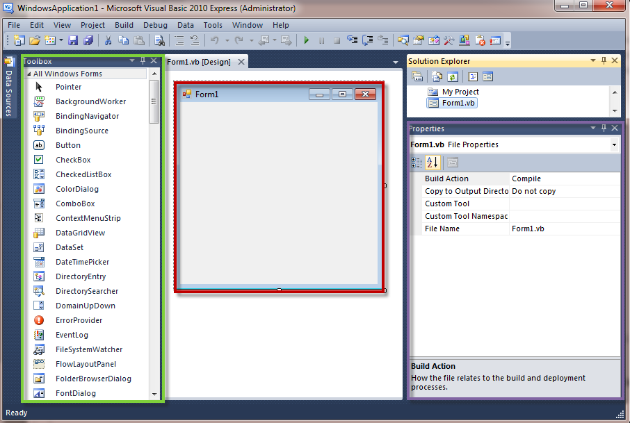

Now open Visual Studio Express and select New Project from the File menu. A new window will pop open. From there, select Windows Form Application, then click OK. If you done everything successfully, your screen should now look like this:
Now you have all you need to build the Bandwidth Calculator, minus the code. Let me explain what you're looking at above:
- Highlighted in red is a Form. A form, in essence, is a window; hence the name, Windows. A form is an empty workspace where all of your buttons and controls will live, once you put them there. (Notice the form of the calculator above with all of its controls.)
- Highlighted in green is the Toolbox. The toolbox contains all of the controls you will need to build almost anything, including the calculator. (In fact, you can even build your own controls, but I will not cover that in this series.) These controls may be placed on the form as needed. As you can see in the calculator, there are multiple text boxes, sliders, labels, a pie chart, and a button. These all came from the toolbox.
- Highlighted in purple is the Properties window. Every control, or object (including the form itself) has certain properties. These properties can be set and changed both before running the program and while the program is running. Think about the properties of a television. One property is its color. Other properties include the TV's height, weight, picture resolution, and so on. The reason the button on the calculator says, "Reset" is because I changed the Text property of the button in the Properties window to read, "Reset."
