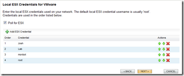

Question: So I don’t have SNMP currently setup on my ESX servers, can you figure out which ones are ESX boxes?
Answer: Yes, if you setup a discovery profile in Network Sonar you can choose to Poll for ESX. We will the analyze the discovery results to determine which IP’s we discovered which support the VMWare API (see the first screenshot below). Even if you don’t have the credentials we will notify you that we found some ESX servers (see the second screenshot below).

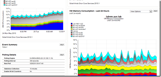

I always like to end with some sweet screenshots, so check out below which I took from our online demo here
