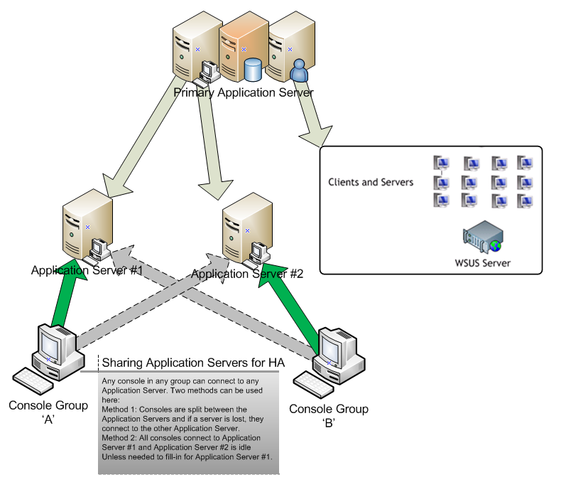

A scenario where multiple application servers would be appropriate is when managing a large number of Patch Manager console users, or where high-availability requirements exist. In a High Availability (HA) scenario, there would be three Application Role servers implemented:
- The primary server (PAS) is not used for console connections, but only as a control system for the Patch Manager environment. It should be backed up regularly.
- At least two Secondary Application Role servers (SAS) would be implemented. These servers primarily handle console connections and task management. Consoles can be split across the servers for rudimentary load balancing and individual console users would connect to the alternate server if their home server was offline, or the servers can be designated as an active/standby pair, and the consoles would only connect to the standby server if the active server is offline and immediate access is required.
This HA scenario can scale to as many Application Role servers as are required. Theoretically, each console user could have their own dedicated Application Role server installed on their personal systems.

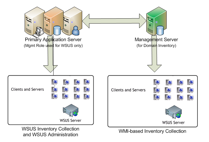

Scenario 2: Using a Management Role server to segregate patch and asset data
One use for an additional Management Role server is to physically segregate the patch data collected from the WSUS server from the asset inventory data collected from the Managed Computer Inventory (WMI) task. This might be done for performance reasons, providing better report generation from smaller databases, or because an organization has a large dataset and does not want to invest in a licensed instance of SQL Server.
For some environments, the 10GB database size limitation of SQL Server 2008 R2 Express Edition may not be sufficient for both WSUS (patch) data and WMI (inventory) data. The primary Patch Manager server can be used to hold the data for the WSUS inventory, and a second Management Role server can be configured with a management group just for managing domain and asset inventory data collected via WMI. This implementation would look something like this:
Because the data is physically segregated, this significantly reduces the size of the database that must be accessed for generating reports. Patch management reports come from the database server containing patch data, and asset management reports come from the database server containing asset inventory data. The smaller datasets will result in faster rendering of reports.
Finally, security controls can also be applied in this scenario, so users who should only have access to patch data, can be physically and logically isolated from the asset inventory data, or vice versa, and users who need access to both can still have full access.
