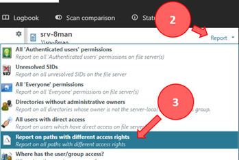

(1) Navigate to the Resources view in the ARM thick client by clicking on Resources in the navigation bar.
(2) Click on Report at the upper-right side of the window and (3) select Report on paths with different access rights.
(4) Add all file server Objects you want to investigate in the report configuration window opening. Click on Start in the lower-right side of the window to execute the report.

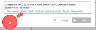

(5) After report execution has finished, open the report by clicking Show report.
In the XLSX report now opening, switch to the sheet holding the information for your fileserver and add a filter to the column Inheritance activated for “off” entries. The filtered list will now show all relevant folders.
It’s a good idea to review this list and remove folders that shouldn’t be protected from inheritance in general. Together with the list of resources already known, you have now a good list to support you in discussions with the departments to find the correct data owner contact for each resource.

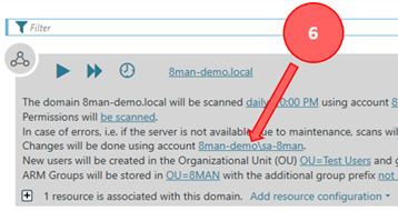

(6) First check to confirm the AD scan is configured with credentials allowing to perform changes in your AD. You find the view below in the ARM configuration client under Scans.

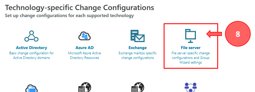

(8) Click on File Server in the technology-specific change configurations section.

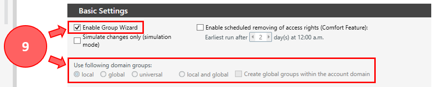

(9) In Basic Settings, activate the Enable Group Wizard checkbox and choose the group type for resource groups to be created. Please note, the group type selection can be only done once. It can’t be changed after the configuration has been saved.
More information regarding the use of AD groups can be found on pages 293 to 299 in the ARM Administrator Guide and in the article Understanding Groups (
2020 Microsoft, https://docs.microsoft.com/en-us/previous-versions/windows/it-pro/windows-server-2008-R2-and-2008/dd861330(v=ws.11), obtained January 30, 2020).

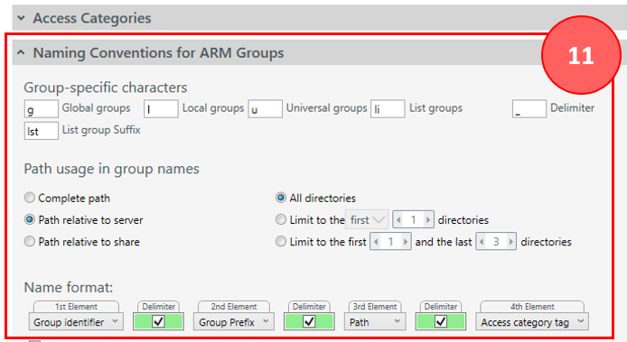

(11) Adjust the naming convention for your resource groups (ARM groups) in the Naming Conventions for ARM Groups section.

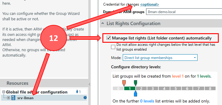

(12) Select each file server, configure change credentials (these will be used by ARM for the actual change operation on the file server), and activate the automatic management of list groups by checking the Manage list rights option in the List Rights Configuration section.
Note, you can find more information on how to set up the file server change configuration starting at page 286 in the ARM Administrator Guide.

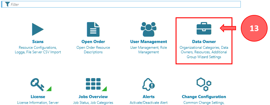

(13) To start your configuration, navigate to the Data Owner view in the ARM configuration client by clicking on Data Owner, the top item in the last column.

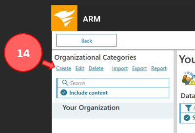

(14) Now add a new organizational category by clicking Create on the upper-left side of the window—note, I already created the root category Your Organization.
(15) In the window now opening, add the name Marketing, an optional description to be displayed, and click Apply.

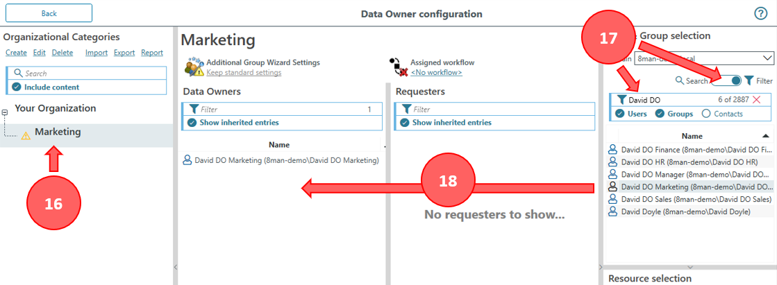

(16) Select Marketing, (17) switch the User & Group selection to Filter and start to filter the list for your data owner. (18) Drag and drop the data owner to the list of Data Owners.

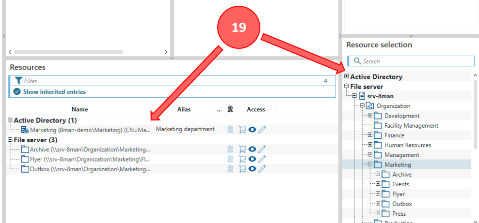

(19) Search and select the resources in the Resource selection pane and drag and drop these into the Resources list.

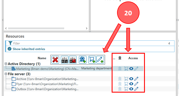

(20) Configure the data owner access permissions to each of the resources as required.
For now, it’s sufficient to provide the “read” option if you just want your data owner to be able to see who has access and the “write” option to allow your data owner to change memberships or permissions on resources.
