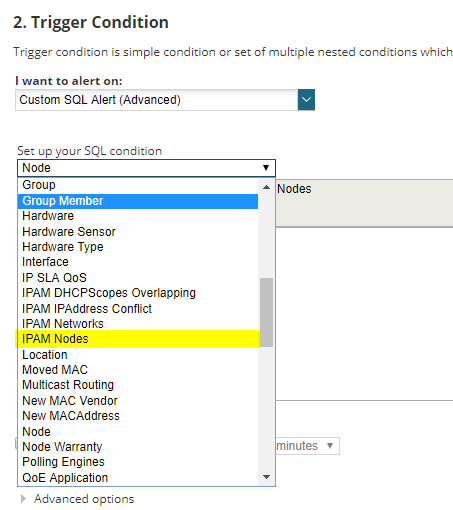

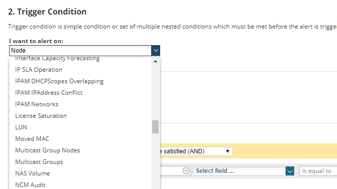

Looking at the native Orion alerting there is no suitable object to work with .

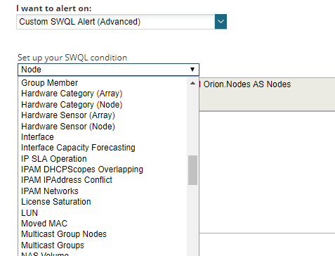

Looking at a Custom SWQL alert does not provide any additional options

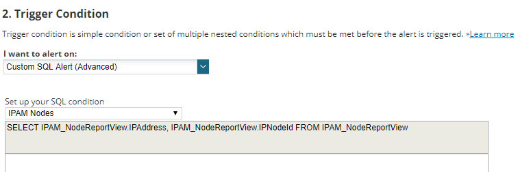

To create this alert we need to use a Custom SQL alert which allows us to query the IPAM_NodeReportView view
There are a couple of fields of interest in this view.

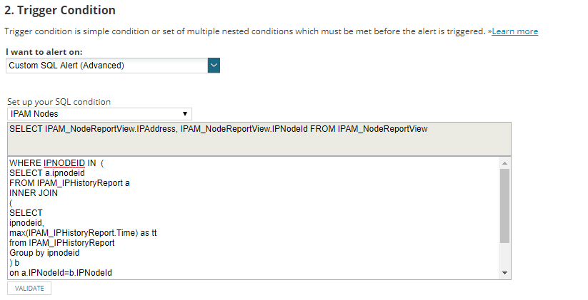

So we need to limit the scope of the alert to the most recent record for each I.P. to to that we join on the same table selecting the maximum time for each I.P
The end result:
WHERE ipnodeid in (
SELECT a.ipnodeid
FROM IPAM_IPHistoryReport a
INNER JOIN
SELECT
ipnodeid,
max(IPAM_IPHistoryReport.Time) as tt
from IPAM_IPHistoryReport
Group by ipnodeid
) b
on a.IPNodeId=b.IPNodeId
and
a.Time=b.tt
where a.FromValue='Available' and a.IntoValue='Used')
