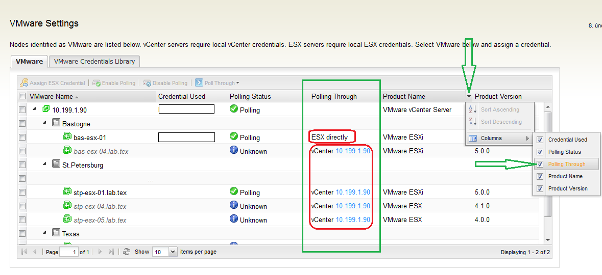

Whether the ESX host is or isn't polled through vCenter can be checked on Visualization settings page.

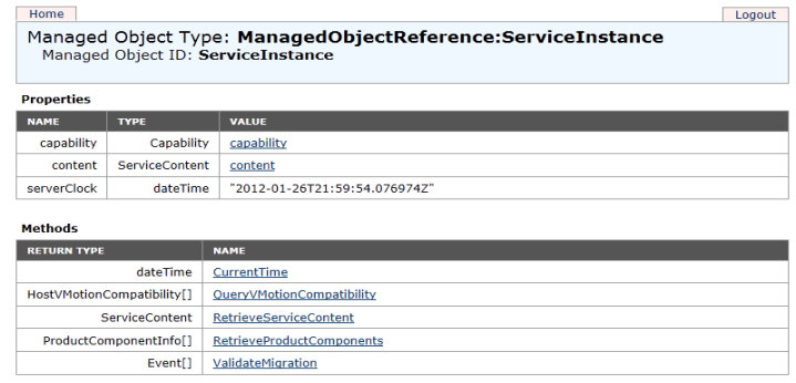

If you are not familiar with it you can access it using this URL: your_vCenter_server/mob ==> your_vCenter_server either its IP address or its host name.
This will open the Managed Object browser page. From there you will continue (I wrote the names of the properties you should follow).

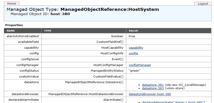

Then you have to find the ESX host object. It's quite complicated but it should get it using following properties:
content -> rootFolder -> childEntity (choose datacenter) -> hostFolder -> childEntity (choose domain) -> host (choose ESX host)
You should see page similar to this:

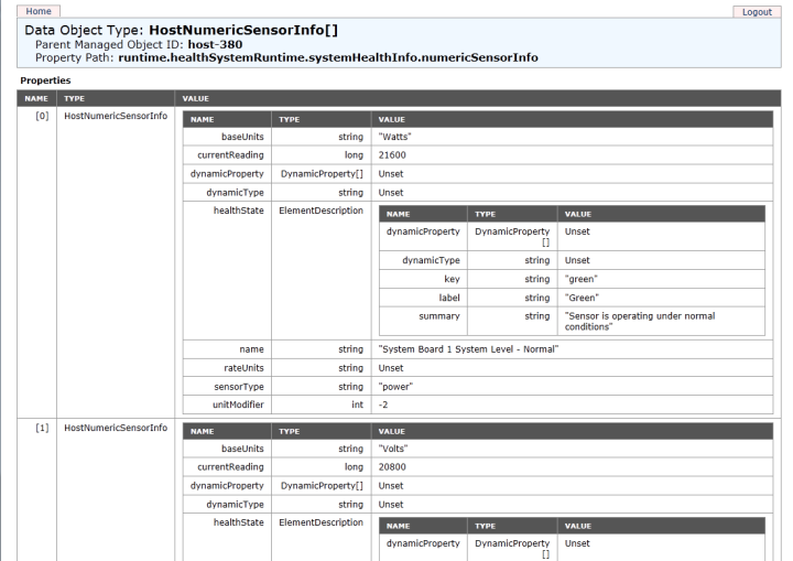

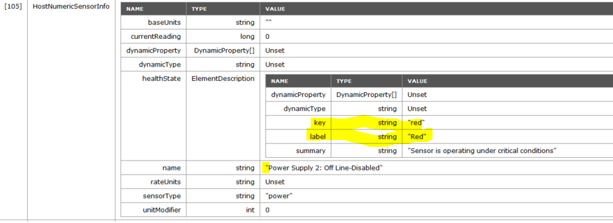

Now you can try to find HW health information:
runtime -> healthSystemRuntime -> systemHealthInfo -> numericSensorInfo

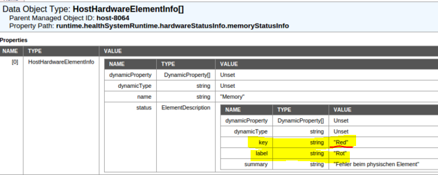

Except the Numeric sensors there is number of other sensor in other location's which we monitor. Here are alternative paths which you can substitute with the one for numeric sensors.
runtime -> healthSystemRuntime -> hardwareStatusInfo -> cpuStatusInfo
runtime -> healthSystemRuntime -> hardwareStatusInfo -> memoryStatusInfo
runtime -> healthSystemRuntime -> hardwareStatusInfo -> storageStatusInfo
