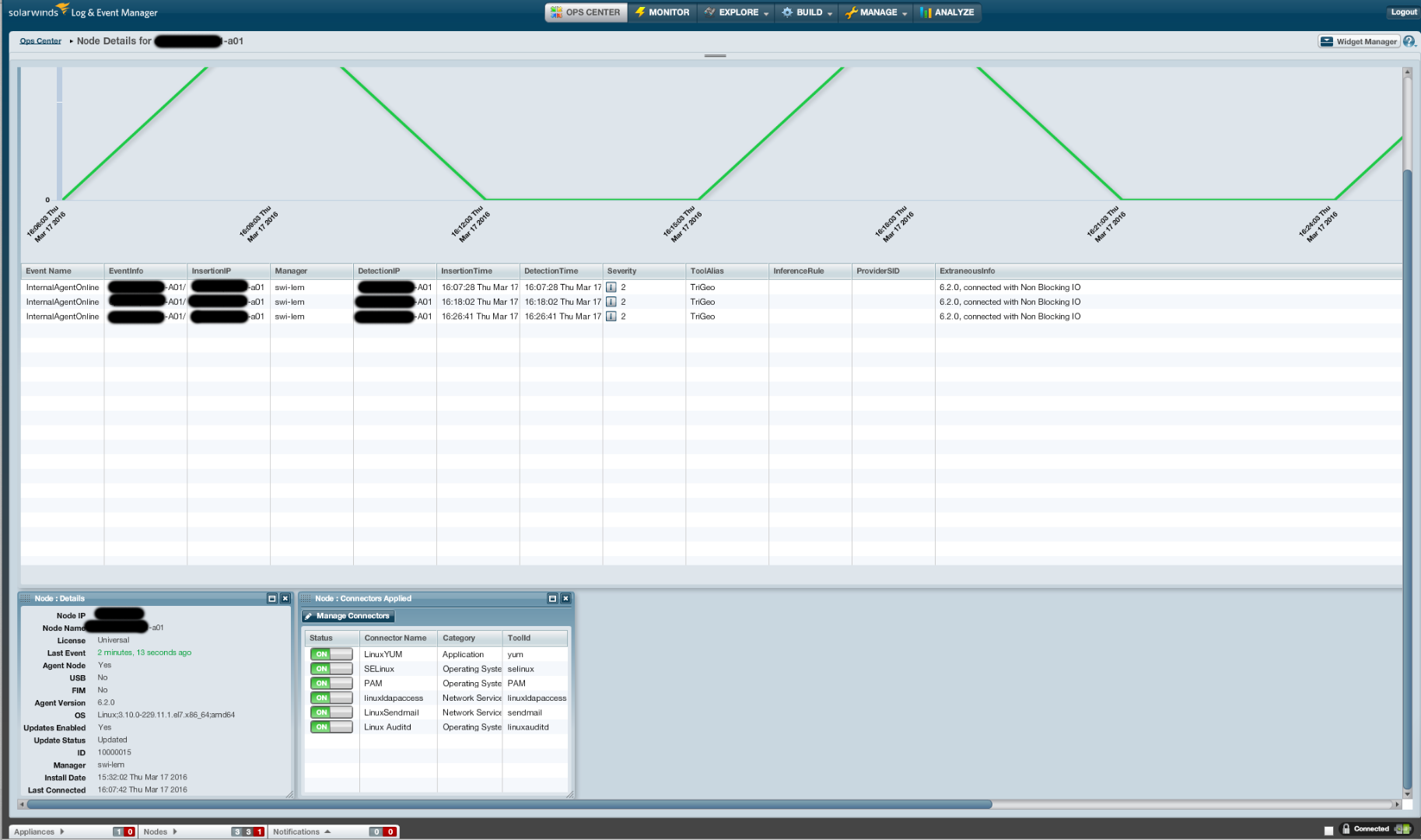

We are just rolling out LEM (6.2) and have hit a speed bump while configuring our Linux infrastructure for LEM. After installing the linux agent on a RHEL 7 box (first one we've tried, and our current standard), I configured the connectors for that node via the LEM console. I was also mindful to reference appropriate log locations. Most are set to use alerts and nDepth. At least one is just set to alerts.
However, unlike our syslog hosts and Windows agents, I have yet to see ANY log data with the exception of the agent restart process. On my firewall, I can verify I see the the connection from host to lem (port 37892) is torn down when I stop the agent and rebuilt when I restart it. I tested with both security events and installing a package via Yum.
Please see the node configuration in this screenshot...
Note only Agent start and Agent stop events are passed. Running user is root.
