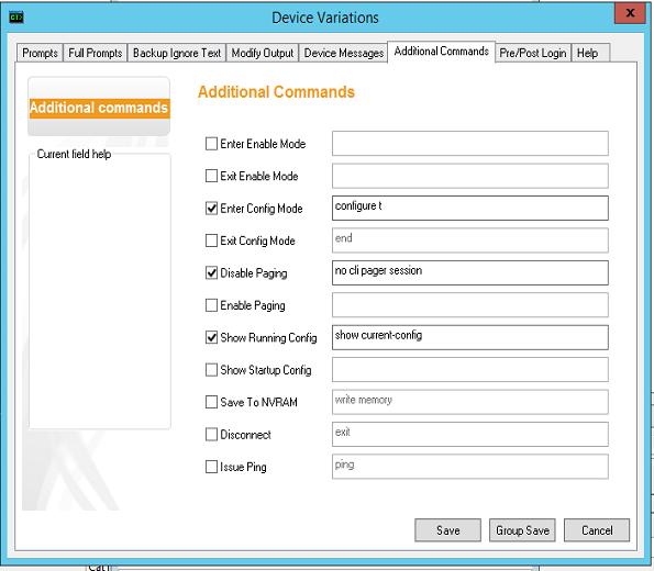

So I got this to work by chatting with support. We ended up having to set some parameters in variations. Hope this helps:
You can edit the device , and use the Variations option. Go to the Additional Commands tab, check the Show Running Config box, and enter the correct command.

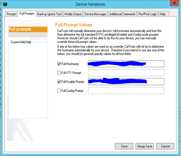

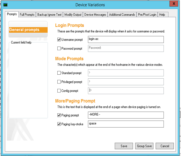

Please post a screenshot of you prompts tab, and the prompts tab of Variations if used.
I have none.
