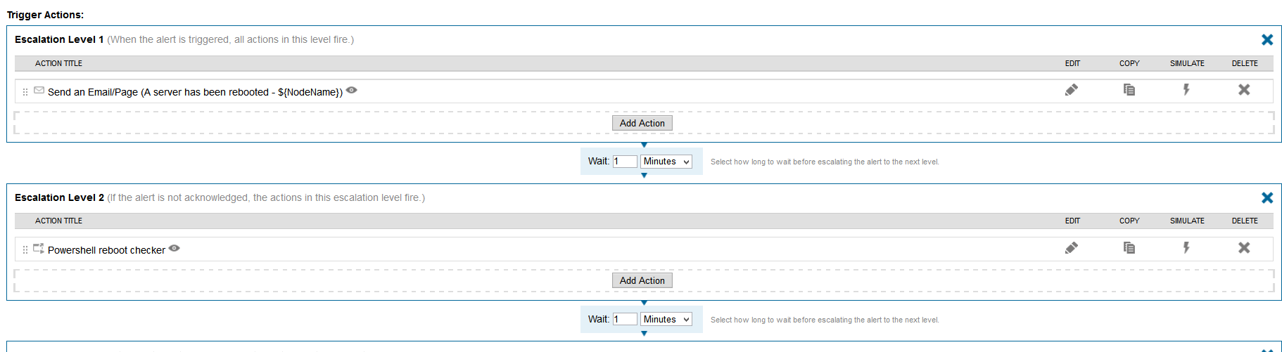

Breakdown
1. A person, robot, aliens, etc .... reboot a server that we have monitored.
2. We get an alert stating that the server has been rebooted and we get specifics on the reboot.
3. If we know about the reboot, we acknowledge the alert within 2 minutes and that is the end
4. If we don't acknowledge the alert, I then have a powershell script that goes out and pulls the 1074 events from the event manager on that server and emails the output to our team. We then know who rebooted and if they are kind enough to say why, then the why. This makes it much easier.

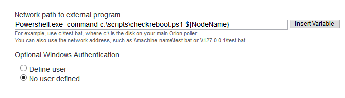

2. This is the most important part. Solarwinds alerting has a very nasty bug that won't do Windows authentication when setting up the alert. No matter what you use, it will say ummm no. I will explain how to get around this in the next bullet.
This is how I have the command set to run the script. Node name puts the server name in for the server it is alerting on.
3. For authentication you need to go to services on the SAM server and change the "Solarwinds Orion Module Engine" to run as and pick the user who has keys to the world. We have a solarwinds service account set in AD for this so that is what we use. Weirdly that is what is used to run the script against. If you left it with local user, it would never authenticate with any servers and you would never get any results. I spent weeks on and off trying to figure this out. Was to told it was the alerting service but support and others were wrong.
Once that is setup you should be all set. Here is our reboot breakdown in triggers.
