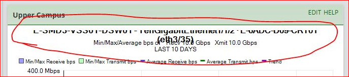

I recently had a situation where a newly-built Custom HTML resource wouldn't display properly. It looked like this:
It displays the interface alias of a switch port using the Custom HTML resources. This view had Interface Alias information overlapping text. That made it hard to read, and made poor impressions on anyone looking at it. It made it look like Solarwinds NPM isn't a well-designed product. However, other Custom HTML resources pointing at other points on this same switch looked proper:
I swapped the Custom HTML out and found the problem followed the switchport with overlapping text. It didn't matter if it was in the right hand column of the Custom View or the Left.
I deleted the Custom HTML and rebuilt it. No improvement.
I compared two switchports' Custom HTML code--the wonky view and one that looked good. The ONLY difference was the Element ID number of the two elements.

But what was the ultimate cause, you may wonder? Here's the secret sauce that wasn't in Solarwinds' Tech Support KB or offline resources: This switch had inherited its management IP address from an older switch that used different hardware. Originally the IP address was associated with a Cisco 6509 VSS pair. When I retired/replaced them with a newer Cisco 6807 VSS pair, I kept the same management IP address on the new switch. And my Solarwinds deployment began showing grayed-out ports it had learned from the 6509--which were not longer present on the 6807.
This information shows up as Interface Unknown entries. One would logically expect NPM to remove these previously-discovered interfaces and update its database either when NPM does a scheduled Discovery, or manual Rediscovery, or scheduled or manual Inventory, plus a new polling of the node. But one would be wrong to expect this, apparently.
I found that I could clear out the problem if I would completely delete the Node with Unknown Interfaces from NPM and then re-Add it. The grayed out ports that were Unknown Interfaces disappeared.
Better still, this ALSO cleared up the overlapping HTML line problem that started it all in the first place.
