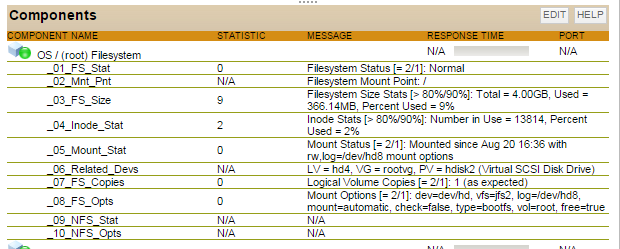

Threshold values shown for Component with triggered Event:
Threshold values NOT shown for Component without triggered Event:
Today I have built into my monitor scripts the ability to create field prompts that provide the general user with a readable field name (also see my Feature Request and vote there) prompt that includes the equation term, Warning threshold value and Critical threshold value (aka "Value Name Prompt" here). The threshold representation is shown within the square brackets ("[ ]") as part of the message in the above examples.
Part of this Value Name Prompt is hard-coded. The Warning and Critical values are downloaded in variables from SAM along with the script to run on the monitored node. However the "=" and ">" signs are hard-coded into the script meaning that if the equation term is changed within the SAM Component Monitor, this display would be incorrect and thus would throw off manual evaluations like described above.
