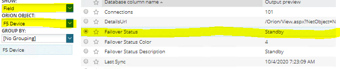

I created 5 different alerts, one for each state of the "F5 Failover Status" (Unknown, Offline, forcedOffline, Active, Standby) My expectation is that when ever one of the Applainces changes state, it will trigger one of these alerts and the name of the alert tells me which state the applaince just went into... The email comes to me with the subject "myltm.mycompany.org F5 Status > Active {date} {time}"
Have yet to see a unscheduled failover, but I did get about 50 alerts when I first added them that gave me the current state of everything...
-Stephen
--Update: I have seen a couple failovers and the notifications are working as expected. I get an email for the old Primary going Standby and a second email for the previous StandBy going Active...

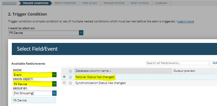

This looks like it is current supported.
Event
Status
