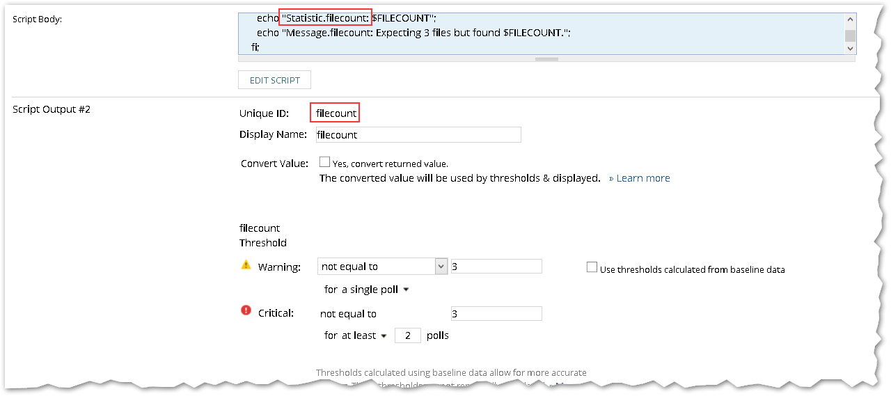

You can give your output a custom label by doing Statistic.<name>. e.g. Statistic.Name, Statistic.FileCount, Statistic.Label, add whichever helps after the Statistic., just make sure there are no spaces in the name. The .<name> is not required but is helpful if you return multiple values from the same script. You can report up to a max of 10 statistic values per script.
You can also have an optional message(text) returned with the statistic value. If used, the Message name has to follow the same name being used with your Statistic. e.g. Statistic.value1 and Message.value1, Statistic.value2 and Message.value2. If your Message.<name> does not match your Statistic.<name> then SAM will throw an error. The Message is optional, it's only if you want to return additional info on top of your statistic value. The Message can merely return informational text or error information. Depending on the needs of your script you could create different if/then/else statements, based on the statistic value which can have different Message formats to help understand what your script is doing.

Example: If i created a script that outputs "Statistic.filecount" then it'll use filecount as the variable name where I can set my warning and critical thresholds. You can also see that i'm including a Message.filecount in the output to help me better understand the issue if it goes into alarm.

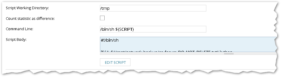

Linux Script Monitor
There are a few more settings on the Linux Script Monitor that need to be set for it to function properly.
- Script Working Directory: /tmp <-- You can change this directory if you prefer, but I always set it to this
- Command Line: <scripting language path> ${SCRIPT} <-- You don't have to include the entire path but I like too just in case. The check transfers everything in the Script Body section to the Linux server and then executes it. The ${SCRIPT} tells SAM to reference that script body.
- perl ${SCRIPT}
- python ${SCRIPT}
- bash ${SCRIPT}

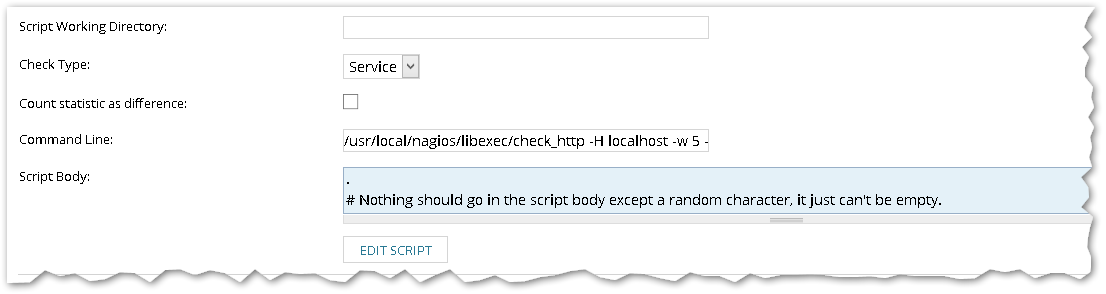

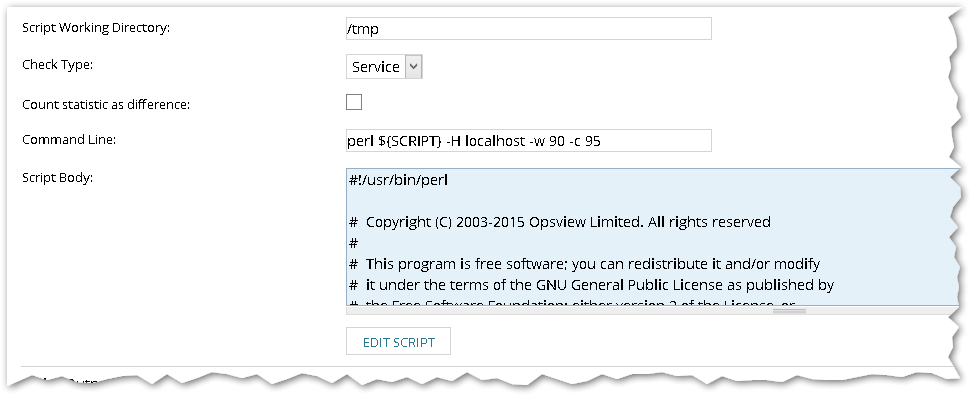

**This means that ALL checks are executed on the endpoint node, not SolarWinds. This is important since most Nagios Plugins require you to specify the hostname with -H. In these cases you'll want to change the check to use -H localhost as pictured below.
***I've seen instances where the Nagios script doesn't like localhost. If localhost doesn't work but testing with a hard coded IP/Hostname does, then you'll need to modify the Nagios script directly to use an Orion variable (See Misc section below). In the Nagios script, where it sets the -H parameter into a variable, force that variable to equal ${IP}. The ${IP} is an Orion variable that pulls the IP of the node the check is run against in Orion. This is only needed in rare occasions.
If you have access to view the code of the script, then copy/paste it into the Script Body. In the Command Line is where you'll place your Nagios parameters. Replace perl with bash or python based on what the script is using.
If the Nagios script is a compiled binary file (ELF), then there is more work involved. Since we can't transfer the script to the server during the check then that means that it has to already be on the server. Your Script Working Directory can be blank. The Script Body just needs any character (can't be empty).
The Command Line is where you'll place the full path to the script along with all of the Nagios parameters.
