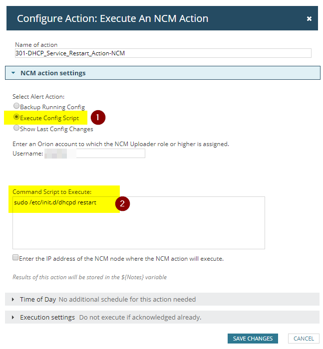

For me, I needed a way to alert when the service has stopped, as well as run a simple command to restart the service. As I have more experience using NCM than I do SAM, I already knew this could easily be accomplished within the native alert/trigger action (Execute An NCM Action).
So, using NPM, SAM, & NCM together, I setup my new alert trigger to alert on the "Component". For this specific use, I felt it would be easier to simply hardcode everything into the alert, as it was for a very specific purpose and I wanted to make sure it ran correctly in the simplest form. Perhaps I'll go back into it later and revise it, though I doubt it since it's working perfectly.
So, we are now alerting on the component, which is watching the status of a specific process via SAM stats. Once it detects the service/process has stopped, the alert gets triggered, and we will need it to run our command.
To do this, we simply add "Execute An NCM Action" as a trigger action, tell it to "Execute Config Script", then give it the command to execute. In this case, we are restarting the dhcpd service.

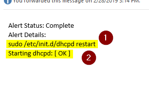

While my priorities were to know about the issue (get the alert), and recover from the issue as quickly as possible (execute NCM script), I also wanted to know what was going on in between. For this, I simply added a 1 minute escalation, and included the ${Notes} variable for the node.
The notes variable is where NCM stores the command results, which will allow us to determine if the script actually ran successfully.
Here is what that part of the escalation email looks like, showing the command we ran, as well as the results.
