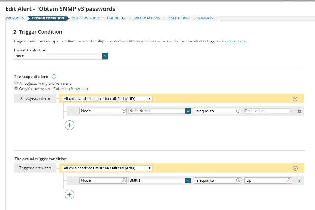

- This is the tricky part. You do not want to have to sort through thousands of emails to get the information. What I did is:
- Set the “I want to alert on” to Node
- Under the scope, select “Only following set of objects”. This will bring up a separate selection screen
- In the first box, Leave the selection of Node. In the next box, choose Node Name. Third box shodul say is equal to. In the last box, just start typing the name of one of your devices (this does not matter now, will change later)
- In “The actual trigger condition” section, leave Node in the first field. Second field should be Status. Third box should be is equal to. Click the arrow in the last box and choose Up.
- When you are done, it should look like this
- Click Next

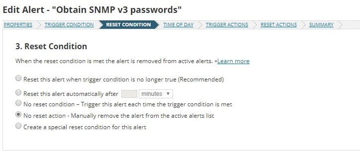

- Change the Reset Condition to No reset Action – Manually remove the alert from the active alerts list.
- Click Naxt

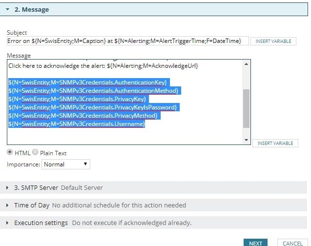

- Now we are going to add an Email Action.
- Click on Add Action.
- Give you action a name.
- Recipients should just be yourself. No need to send passwords to anyone else
- Under message, you can replace everything else with the following items
- ${N=SwisEntity;M=SNMPv3Credentials.AuthenticationKey}
- ${N=SwisEntity;M=SNMPv3Credentials.AuthenticationMethod}
- ${N=SwisEntity;M=SNMPv3Credentials.PrivacyKey}
- ${N=SwisEntity;M=SNMPv3Credentials.PrivacyKeyIsPassword}
- ${N=SwisEntity;M=SNMPv3Credentials.PrivacyMethod}
- ${N=SwisEntity;M=SNMPv3Credentials.Username}
- Set your SMTP server
- Click Next
