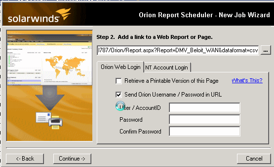

So, when you make the report in report scheduler, copy the URL of the report you want to send out, and at then end of the URL put &dataformat=csv.
Also on the same page where you put the URL, also make sure that the "Retrieve a printable version of this webpage" is unchecked and then make sure that the "Send Orion Username/ Password in URL" box is checked and then put in your Orion username and password.
