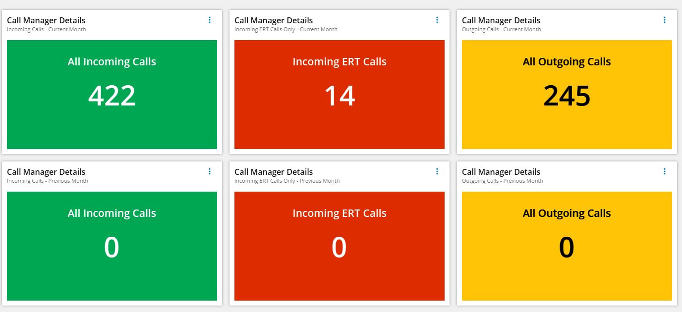

We recently upgraded our Solarwinds Platform 2024.4.2 to Solarwinds Observability Self Hosted Advanced Enterprise 2025.2.1 and we have seen a few oddities with some of our previous custom SWQL Dashboards that pull information on our Call Manager Installation.
We created a dashboard that showed us the number of incoming calls / Emergency Calls and Outgoing Calls for the current / previous month, but as you can see from the screengrab below, it no longer shows any data for the previous month.
also below is the swql that was used to create this information.

Now on closer looking and breaking the above down, it appears that the orion.IpSLA.CDRDetails table no longer contains a field called 'OriginalCalledPartyNumber' after the upgrade to HCO and therefore the table produces no data.
I have managed to alter the swql slightly so that it produces data now - as per picture above, however the historical info (i.e. last month is still empty) as it apppears that we now only have data available via this query from the 4th October despite upgrading to HCO on the 1st October.
