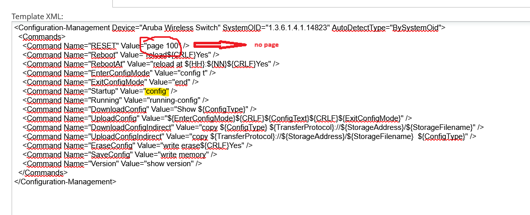

I have create a backup task for HPE Aruba 2930M (for runnuing and startup).
It seems working for running configuration but for the startup config there is an error. For the startup config, the script try execute the following command [show configuration], but the switch doesnt know this command, the true on is [show config].
The question:
Is it possible to modify the script that is executed or create a custom one, or fix the existing (i presume the script is located somewhere in the SW installation folder on the server).
