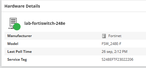

i am trying to make an inventory report for my fortinet devices and now i am struggling with redundancy device data like serial numbers, model names. can anyone suggest a way fetch the data.

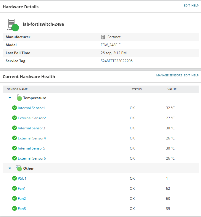

There where some additions to HW inventory on fortinet devices added in version 2025.1. You can get data like this:
But if there is more details you want, you probably have to create that with UnDP's as @HerrDoktor said.
