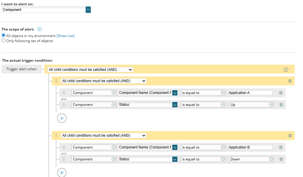

The question is similiar to this conversation:(+) Component Alerts - Forum - Server & Application Monitor (SAM) - THWACK
The point in this case is that, if I am right, complex alert configuration does not check if the applicatoin / component in the first condition belongs to the same node that in the second one. I would like to configure one alert for several nodes .
Have you tested to create an alert rule like this:
One alert for several nodes is thinking in the right direction.

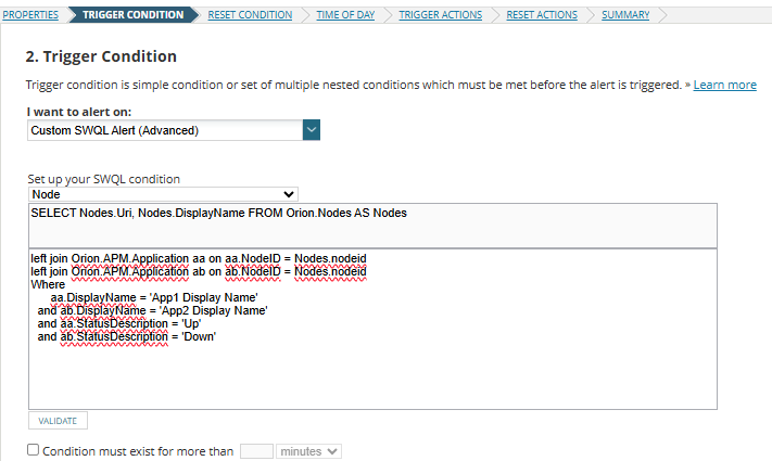

What you are looking for is a SWQL query alert, and likely you want "Setup your SWQL connection:" , Dropdown -> "Node". Using node seems counter intuitive, and technically it could work either way, and both are complicated.

Here is the example SWQL I was talking about, if you wish to pursue that route, instead of taking my obviously superior advice. (just kidding there is no one size fits all monitoring and alerting).
Here is the Text of the SWQL: NOTE that first line above is provided for you (and cannot be modified), while below has more fields so I can see things better in SWQL studio.
SELECT top 10 Nodes.Uri, Nodes.DisplayName, aa.DisplayName, ab.DisplayName, aa.StatusDescription, ab.StatusDescription FROM Orion.Nodes AS Nodesleft join Orion.APM.Application aa on aa.NodeID = Nodes.nodeidleft join Orion.APM.Application ab on ab.NodeID = Nodes.nodeidWhere aa.DisplayName = 'App1 Display Name' and ab.DisplayName = 'App2 Display Name' and aa.StatusDescription = 'Up' and ab.StatusDescription = 'Down'
https://github.com/solarwinds/OrionSDK/releases
Download the SDK MSI and install it, that will get you swql studio.
