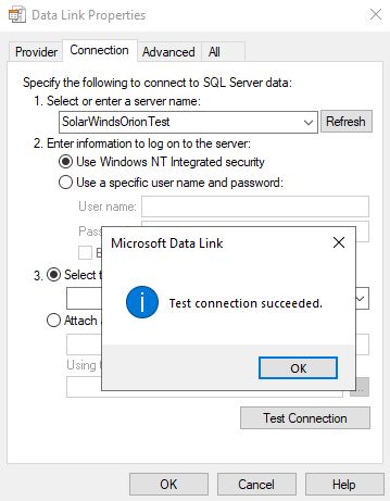

I agree it should "just work", but sadly it doesn't. If I test the connection with a .UDL file it tests successfully.
I've created the alias using the cliconfg.exe tool.

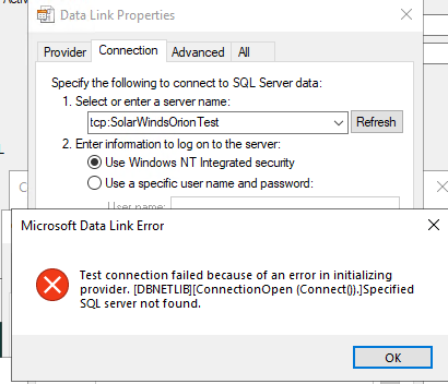

Maybe it has something to do with the automatic SqlConnectionFormater that the Config Wizard is doing?
Because using the corrected string in the .UDL file doesn't work as well:
