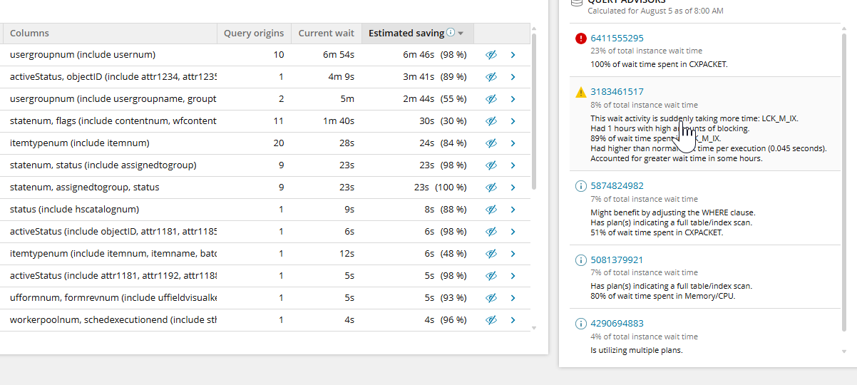

Can I create a report that will send me the top index recommendations from a server?
For example, can it send me these values in a report once a week?
Hi @danglenn , DPA does not include a report for index recommendations, but here is a script you can use to mine the DPA repository for this information. Note that this will show advisors from all instances and rank them globally by the time savings metric: https://thwack.solarwinds.com/kb/articles/3434-global-index-advisor-with-time-savings
