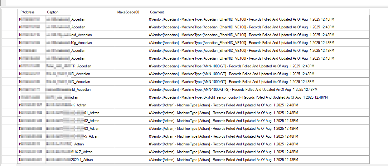

The first thing I wanted to do was to standardize the formatting and naming convention of the StaticHosts file. The main PowerShell script runs a SWQL query to list all nodes, formatted to fit the StaticHosts file requirements, having IPAddress then Hostname. I've always struggled to find the balance between building insane filters and rules, and building out insane hostnames. Over the years I've settled on simplicity. I take the hostnames and remove all spaces and other such garbage chars, then attach a simple underscore followed by the vendor. Additionally, I add a comment to each line to specify vendor, machine type, and a datetime stamp of when the script was ran.
With the naming good to go, it helps me cut down on filters and rules. Now, I can easily just group by vendor, which solves most of my issues. Previously, I had been using vendor and machine type, but that was too specific, and would often miss messages I needed, or caused me to create additional filters and/or rules. What I have now works for me and is, in no way, the best way for anyone else to do it.

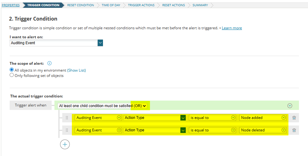

Next up, if you want it to run on a schedule, that's easy enough to do on the server itself. However, if you'd like, you should be able to fire the script via the alert manager, whenever the system detects "Node Added" or "Node Deleted" audit types occur. Make sure the "Trigger Actions" tab is configured to fire off the script, and you should be good to go.
