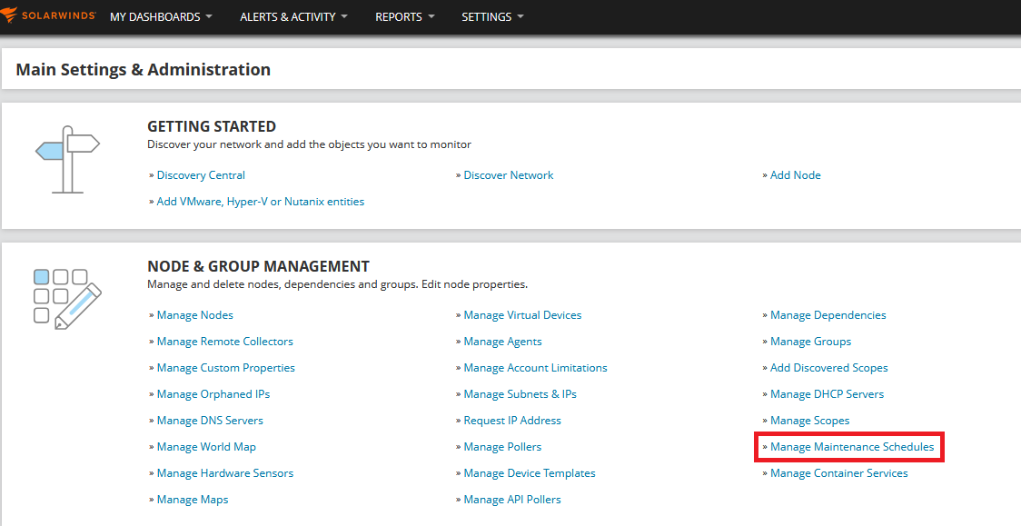

1. You need to create a Maintenance Schedule in SolarWinds. In 2025.2, you can do that here:

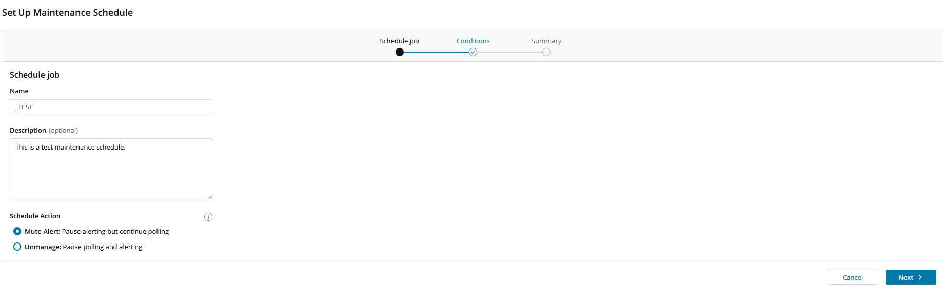

2. Create a new Maintenance Schedule from `Manage Maintenance Schedules`. In my example below, I called my new Schedule `_Test`, since this is just Demo, I told my schedule to MUTE the alerts.

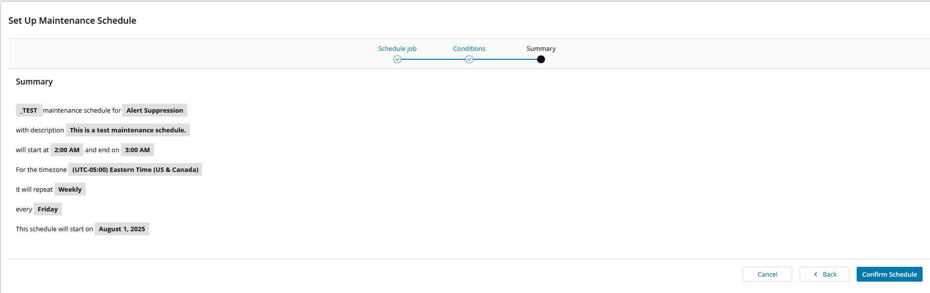

3. Confirm your Maintenance Schedule.
4. You will see your new Maintenance schedule.

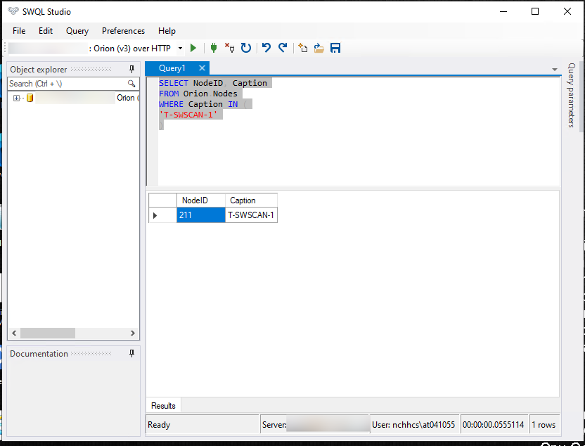

5. Install the SWQL studio from here.
6. Connect to your Orion instance. If you have trouble setting up your connection to your Orion server, check the docs from where you downloaded SWQL studio and check your connection string.
7. OPTIONAL STEP: You dont HAVE to do this step, but I'm adding it anyway.
8. Use the below SWQL Query to get the NodeID of a node to test your new Maintenance schedule with.
SELECT NodeID, Caption
FROM Orion.Nodes
WHERE Caption IN (
'Server1',
'Server2',
'Server3'
Obviously, replace `Server1, Server2` etc with the name of your Node/Server. You should receive an output like this one:
