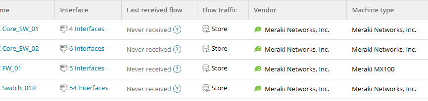

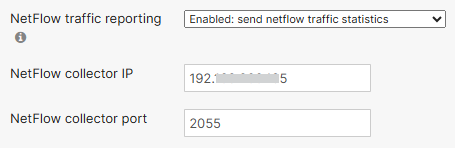

What's the current status on Meraki integration with NTA (or is it the other way around)?
I've looked at past discussions and it seems some people managed to make it work. Not me - at least not yet. I've played with it for a few hours opening the firewall rules for port 2055 on the SolarWinds server, making sure Meraki is set to send NetFlow data, the router (MX100) has SNMP monitoring enabled on all ports - still nada. Didn't try a packet capture yet to confirm NetFlow packets are reaching the Orion server. We also have a Fortigrade 60F device I could try setting up for NTA - but that one has very little traffic and we don't really need to monitor it whereas Meraki handles 99% of all traffic, and see who is talking to whom and how much could be really useful...
NTA:
Meraki:
Is there a guide on how to make it work? (Documentation on either side hasn't been helpful - at least not yet.)
Our setup:
- Orion / NPM / SAM / NTA 2023.3.0
- Meraki MX100, MS225 (along with MX65, 75, MS120, 130, 220 switches, various MR APs)
Thanks!
