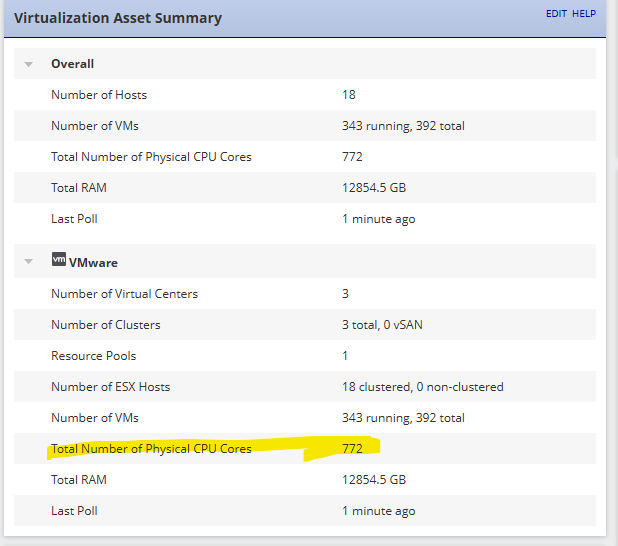

That is a loaded question when working with SolarWinds. If you have Virtualization Manager installed, then you just look at the summary page:

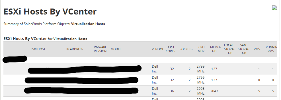

Actually you can get it even without the virtualization monitor. SW does some rudimentary virtualization without VMan. The field, CpuCoreCount, can be found in the table Orion.VIM.Hosts. Here is a SWQL query I wrote for a report on VMware hosts. CpuCoreCount is the last field on the first line.
SELECT N.Caption, H.HostName, H.IpAddress, S.StatusName, H.VMwareProductVersion AS VMware_Version, H.Model, H.Vendor, H.ProcessorType, H.CpuCoreCount,
H.CpuPkgCount AS Sockets, H.CpuMhz, H.MemorySize / (1024*1024*1024) AS MemoryGB,
(Select SUM(V.Size) AS DiskSpace
FROM Orion.Volumes V
WHERE H.NodeID = V.NodeID AND V.Type LIKE 'Fixed Disk')/(1024*1024*1024) AS DiskSpaceGB,
WHERE H.NodeID = V.NodeID AND V.Type LIKE 'NetworkDisk')/(1024*1024*1024) AS SanDiskGB,
H.NicCount, H.HbaCount, H.HbaFcCount, H.HbaScsiCount, H.HbaIscsiCount, H.BuildNumber, H.NetworkUtilization, H.NetworkUsageRate, H.NetworkTransmitRate,
H.NetworkReceiveRate, H.NetworkCapacityKbps, H.CpuLoad, H.CpuUsageMHz, H.MemUsage, H.MemUsageMB, H.VmCount, H.VmRunningCount,
H.StatusMessage
FROM Orion.VIM.Hosts H
JOIN Orion.StatusInfo S ON H.Status = S.StatusId
JOIN Orion.VIM.DataCenters D ON H.DataCenterID = D.DataCenterID
JOIN Orion.VIM.VCenters C ON D.VCenterID = C.VCenterID
JOIN Orion.Nodes N ON C.NodeID = N.NodeID
WHERE H.VMwareProductName LIKE 'VMware ESXi'
The report looks like this
