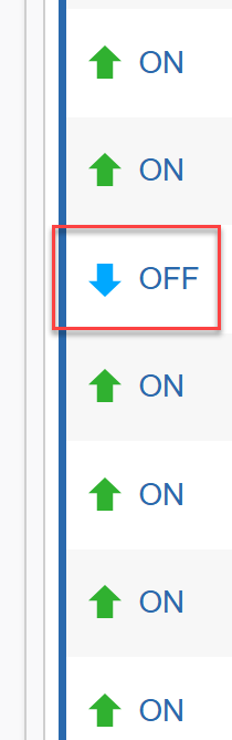

Is there a standard alert that informs the administrator when a DPA monitor is OFF or unresponsive? Or is it possible to create an alert that will effectively monitor the monitors?
