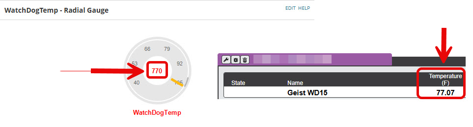

We have Vertiv Watchdog Temperature sensor that shows up as a decimal (75.5 Fahrenheit) in Watchdog's monitor. We added the Watchdog temperature sensors to SolarWinds Orion to monitor and send alerts to the team. The temperature sensor is showing up with non-decimal format (755) and that throws off the alerting (since it thinks it is at 755 degrees).
I've reached out to Vertiv, they said that the product is no longer supported and that they usually ask customers to modify the software (in this case, SW Orion) to convert integer values to decimal. I tried asking Orion support and they said that it wasn't possible. I was hoping anyone could help me figure out how to do this.
Attached is a screenshot of what we are observing.
