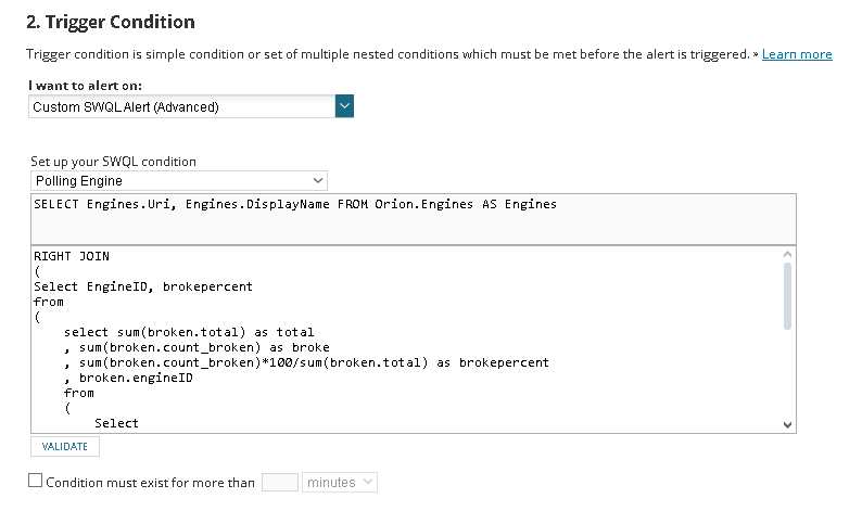

Set your trigger condition to be like this:
Then in the bottom box copy/paste the following:
RIGHT JOIN (Select EngineID, brokepercentfrom( select sum(broken.total) as total , sum(broken.count_broken) as broke , sum(broken.count_broken)*100/sum(broken.total) as brokepercent , broken.engineID from ( Select Case When minutediff(lastsystemuptimepollutc, getutcdate())>=5*StatCollection then 1 ELSE 0 END AS count_broken , n.EngineID , 1 as total FROM orion.nodes n WHERE objectsubtype<>'ICMP' and status <>2 and status<>9 and status<>11 and status<>12 ) as broken group by broken.engineID order by broken.engineID)as countswhere counts.brokepercent > 60) broke on broke.EngineID = engines.EngineID
Figures you may want to adjust are the 60 in last but one line and the 5 in the WHEN minutediff line. What this is essentially doing is saying if 60% or more of nodes on any one APE have failed to respond to SNMP over the last 5 polls then trigger.

I've tried to do this and had a few discussions with MVPs and the end result was that the best way to do this was by monitoring/reporting on the 'Nodes.LastSystemUpTimePollUtc' - however, so long as ICMP is still working we don't deem this as a critical issue. So, the other side of this coin is in monitoring if an APE fails in some manner. As we only have NPM (and not SAM) we have taken a two-fold approach.For the APE's we have an alert using custom SWQL [happy to share if needs be] that looks at the %age of nodes not responding and if > than X triggers and sends an eMail to a team of folks that could respond and check. The other side is a daily report that shows all the nodes that hasn't collected for the prior 3 times. It also triggers a scheduled send once a day.
