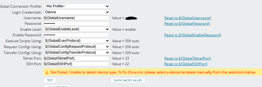

I noticed my solar wind is not showing the switch config for alot of the switches just few. How do I resolve this.
https://solarwindscore.my.site.com/SuccessCenter/s/article/Basic-NCM-Jobs-Troubleshooting-Guide?language=en_US
Most likely your SSH credentials are not working, if those are good, probably you are using the wrong device template.

(3) The node is not correctly configured for NCM. The simple sets are to go into the node properties and make sure that Manage node(s) with NCM is enabled. Next make sure the correct global connection profile is selected. Double check all the settings to validate if the correct request/transfer/ports are being used. If your presented with the Show Macro Values, select it to see the variables used.
If you have multiple profiles use <auto detect> as the global connection profile
If the values are correct then click Show credential log details. This will show any login errors that SolarWinds my present.
If the profile is good and everything checks out accordingly, then the issue is more than likely related to problems (3) or (2).
