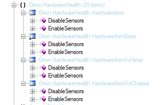

you can try the solarwinds api
there are verbs to enable and disable the hardware sensors.
you can probably scheduled it.
